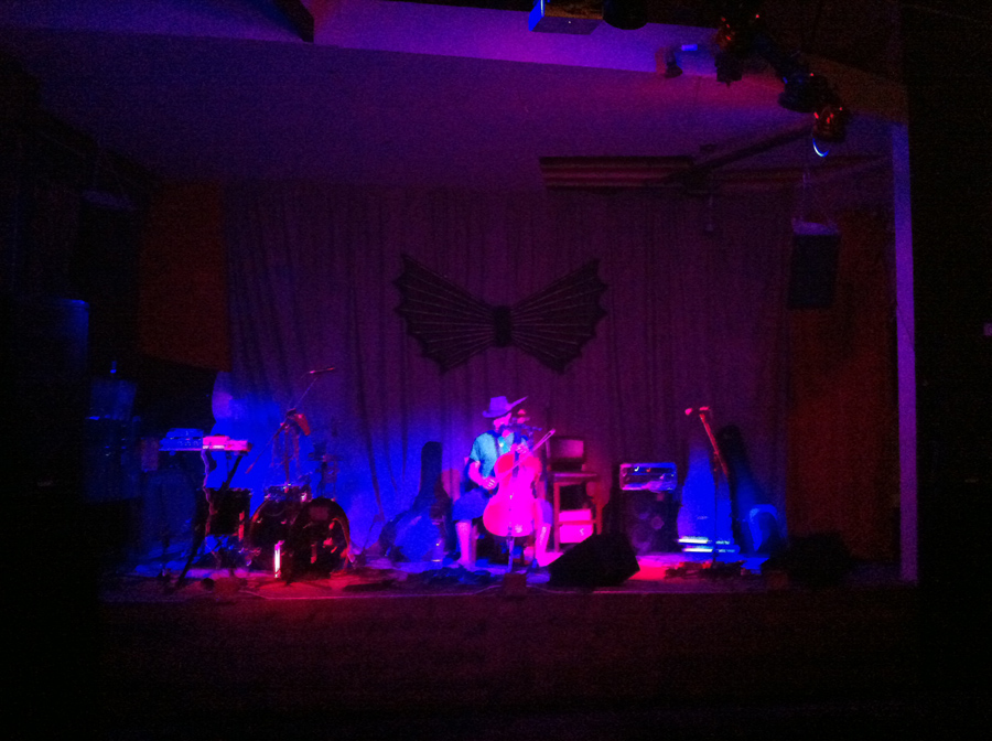

[addendum] I just remembered I took a few reference snaps with my own iphone. here is the stage setup. and my unedited iphone image.

I think the bigger problem is the lack of knowledge how to control LEDs lights (at small clubs/bars). most par lights have RGB LEDs which are on different channels and can be controlled by a lighting mixing board. if you don't have a mixing board then you get default pre-sets on the pars.
some places just don't care about lighting (many don't care about sound! just make it louder!!) this place actually had very good sound for a small club -- they had to add sound damping due to neighbor complaints.
