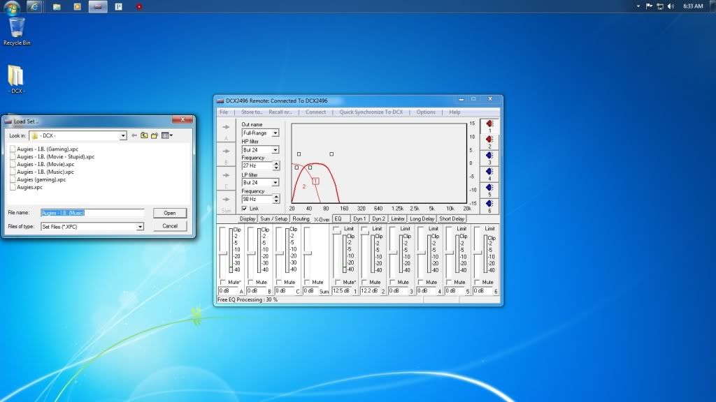

Here's a screenshot of the software I took a long time ago. On the right window, the leftmost slider controlled ALL volume that exits the machine.
It controlled the second and third sliders, which were tied together and were the right and left channels.
On a side note;
The left window are the files for music, movie, infinite baffle subs, "regular" subs, etc....depending on mood and input source.

Only with a +/-15db range.....which might not all be usable considering which input is used (digital or analog) and the applied voltage levels.
It's a long way from being a usable master volume control.
All of the sliders on the DCX2496 were designed for relative adjustments and/or optimizing the system gain structure.
The system volume control (if one exists) would always be elsewhere in a professional setup......which is where this unit was designed to be used.
