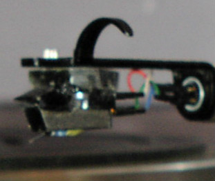

Here's what my 95HE looks like:
Straightforward presentation like your other MMs.  I would guess a little more finesse than your 100E if that still has the original needle.

We're back to recommendations for any cartridge type. If there are any others that you folks would like to recommend, please feel free to do so.
I emailed the guy with the Benz Micro L04 - he says he is the second owner and the cart has roughly 400 hours on it. Is it still worth the $700 he is asking?
Sorry for derailing the original question with the conflicting info I've been providing.
