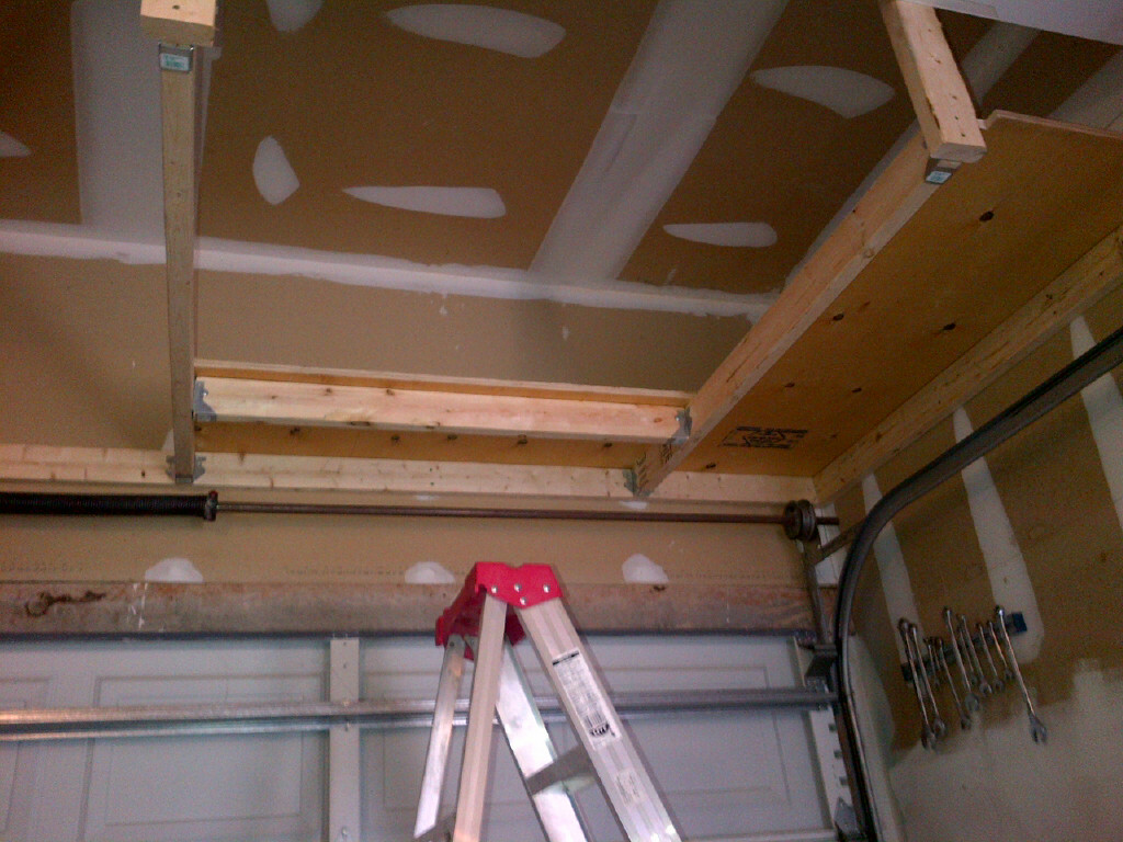

We've lived here for 8 years now, and I have always stared up at this strange space in my garage, at the front, ABOVE the garage door. The way the house is built, the master is over the garage, but the garage protrudes about 5 feet out from where the master bedroom ends, so there has always been this 20 foot wide, 5 foot deep, 30 inch space up there.
Today, I set about putting in a series of shelves up there. I am short, so plenty of time spent up and down the 7 foot ladder. I used 2x4's and appropriate joist hangers, and joist hanger nails, and 3 inch deck screws to hold the 3/4 inch spruce plywood in place.
Basically I have put one side up. It includes a 24x48 inch shelf, and a 48x18 inch shelf, plus a 12x48 inch shelf in a U shape. All are about 25 inches from shelf to garage ceiling. I will install another identical portion later this week.
I put this half up over my wife's van, once I see it holds fine, I will put up the other half over my T Bird!
Here is a WIP pic.

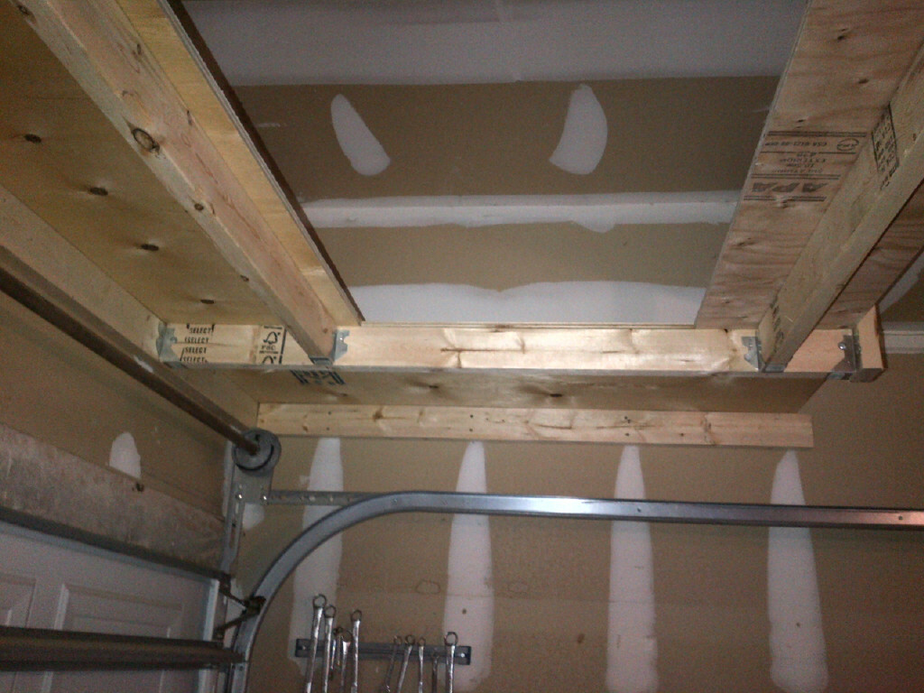

Here is a pic showing the U from below.

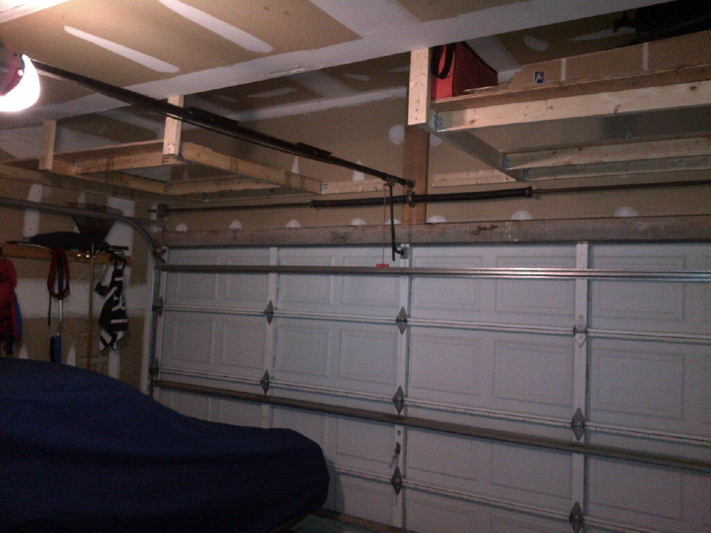

Here is a pic from the door into the house, looking back towards the garage door.
It ain't going to win any accolades for beauty, but I have done chin ups off each main piece, so I know it will hold anything I expect to put up there.
