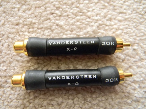

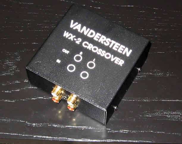

The WX-2 external crossover is included with the 2Wq subwoofer.  It is intended to be used temporarily to determine the proper setting needed to match the input impedance of your power amplifier set via an internal dip switch.  After the optimal setting is determined, then the corresponding fixed X-2 inline crossovers are ordered from a Vandersteen dealer to replace the WX-2 (and the extra set of interconnects).

As described above - the X-2 will replace the WX-2 external crossover after acceptable values for your system/room are found - when satisfied after much value settings trial and error - Vandersteen will custom build the X-2 - to your equipment - four years ago my dealer wanted $400 - I have spoken to Richard multiples times on various topics - I use the stock WX-2 pictured below.

$400 for the fixed X-2 inline crossovers...........ouch!  Can understand why you're stick with the "temporary" WX-2!
