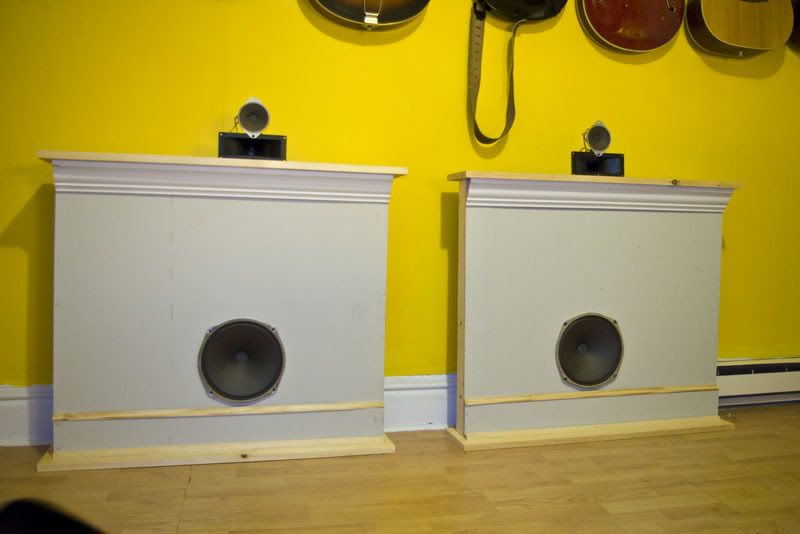

Hi,
I'd wanna try something like these
http://i194.photobucket.com/albums/z26/oneinchsidehop/open%20baffle/Open-Baffle-w-zenith.jpg
obviously in Ob  :)
I know bass near wall will be attenuate, is there something else to take care of? anybody tried something like these?
thanks
nickd
Re: How to OB near wall
« Reply #1 on: 3 Jul 2013, 03:42 pm »
The 'Golden Rule" for OB designs is 3' from the back wall. You might get them to sound OK with a digital crossover or EQ but placement of OB drivers closer than 3' to the back wall will cause problems that are hard if not impossible to correct.
I would stick with a well designed box based speaker if you don't have the rear space. They can "disappear" and cast a huge soundstage too. You might be happier in the long run.
