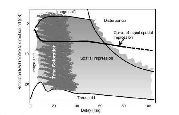

Absolutely no FR issues.  Sorry no test data yet.  Besides, it's highly likely that test data won't look so sexy with the Effect Speaker connected.  Test data would likely rather comprise the Main Speaker only.
We recently moved the "Effects Speaker" (fires toward ceiling) back 15" behind the Main Speaker.  Center ES could go no further because it hit the front wall.  Output from the Effect Speaker now arrives an estimated full 10ms after Main Speaker direct output, even in my low 91" ceiling.  10ms is Dr. Toole's ideal target (difficult to achieve but my Late Ceiling Splash does it).  Per Toole's writings on this subject (the world's premier authority on ambiance and spatial qualities) even if FR issues appeared in in-room tests, the predominance of perceived output depends on the first arriving signal from the Main Speakers.
IOW, you might not like the way test data looks with both the Main Speaker and Effects Speaker.  But if you A-B the Main Speaker alone vs. with the Effects Speaker, it takes of all of three seconds to decide you won't live without the Effects Speaker.
Play the early Chesky test/music CD with system diagnostics.  Playing the "arc test" with percussion instrument on this system, you can trace a perfect arch, no flat section in the middle.  The depth tests are uncanny.  On one live CD audience members sound like they are 75' beyond the front and side walls.
Late Ceiling Splash delay time exceeds that of any other radiation pattern.  Ambiance reflects off the ceiling and this has so many good effects I won't list them all here, plus the ceiling is closer in proximity to the listener than any other boundary and this proximity increases intensity, etc, etc, etc.   I just happened to accidentally discover the best loudspeaker radiation pattern, exceeding by significant margin Toole's 65-degree side-firing method (of which I might be the only person on earth who actually experimented with at length...I don't know if Toole ever built a system he describes in theory...Toole's theory appears to require two boxes per channel...I happened to have six matching Dynaudio Esotec stand mount monitors built to a high standard).
After moving the ES back, we tossed the MS upper and lower "shadows"....now each Effects Speaker has "shadow" (Room Tunes) attached directly to it...looks much cleaner from the front, like three regular stand mounts with Room Tunes 15" behind them.
With the four Distributed Subs it sounds like no stand mount on earth.  Well, actually, it's the best playback I've heard except for possibly Ray Kimber IsoMike DSD 4.0 proprietary system/proprietary recordings with eight Sound Lab stats, four per corner, oodles of Pass Class A.
I could best describe the performance here as density and stage size like the best MBL show demo, but sharp accurate image outlines like the worlds best point source, and individual atmosphere for each image.  It's like Ray's best IsoMike but I can't get the image out as far into the room as Ray's.
