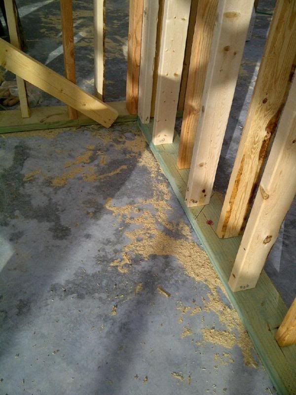

Size is 14x18, hoping to employ all the sound isolation basics. Staggered studs on adjoining walls, double drywall and GG.

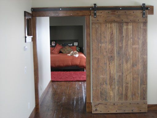

One of the challenges will be a 4' wide sliding barn door as the entrance to the room. Has anyone successfully isolated a sliding barn door?
WGH
Re: New ManCave/Listening Room
« Reply #2 on: 9 Jun 2013, 11:15 pm »
Is the barn door an exterior door or between rooms? Does it have glass for the view or solid?
My first idea is to ditch the barn door idea and go for a manufactured folding patio door, that way you don't have to re-invent weatherstripping and noise control details.
If you must have a sliding barn door then the next best option is to first determine what weatherstrip to use and then design the door and jamb, that is what I do in my day job - design and build custom doors.
I would start by looking at weatherseals from Conservation Technology, I have used their products for years. You can download their catalog under 'Documents'.
http://www.conservationtechnology.com/building.html
The next step is to determine the hardware, choices go from rustic wrought iron to modern. Below are some sliding door hardware options I put together for a client last year for a modern style door, this is the nice stuff.
Stainless Aero Flat Track with standard stainless wheels $838.00
Stainless Aero Flat Track with hush stainless wheels $918.00
Beyerle Flatec II Wood stainless track – top mount $1323.32
There are other more affordable options at: http://www.hangingdoorhardware.com/index.html

Great info, thank you! It will be the interior door entrance. More of the rustic nature like your affordable link.
The weather stripping and isolation is certainly the main concern, thanks for the link.

Sealing the door bottom will be the hardest part, a sweep will rub a line on the floor and may not be soundproof. Usually there is an alignment bracket on the floor that fits into a slot in the door bottom to keep the door from swinging. A bracket on both sides of the door would allow the use of an automatic door bottom. The door would take a little force to close and latch because of the spring in the door bottom but the weatherstrip would drop down and seal tight.
Making the door real heavy will keep if from lifting up when the bottom goes down.
http://pemko.com/index.cfm?startRow=6&event=products.productListing&searchName=Search+by+Category&openFilter=loadCategorySearch&ratingIds=&categoryId=894&productMaterialId=&subcategoryId=917&competitorId=&partCategoryIds=
Pemko has an extensive variety of automatic door bottoms, look for the noise icon in the description
Thanks for the help, i am hoping the drop bottom seal will work. I hope i am not stuck sliding something in front of the door to seal each time i listen.
Ive envisioned some thick rubber weather stripping like on a sliding walk in freezer for the sides. I will check out the links you provided, thanks again.

Ahhhh staggered studs on adjoining walls, aren't they beautiful. :)

The staggered studs should assist with containing the music in that room, and isolating it better from outside it.
You may find it harder to insulate with Roxul now though, you'll have a lot of cuts to make to fit around the extra studs etc, but in my install in the basement, the Roxul was well worth the effort in ceiling and interior walls.
Not really, just use standard 3.5" R13 on each side. Yes -you have to insulate once on each side but shouldn't have to cut any more than normal.

Thanks Bryan, i was thinking about which product to use. The 3.5" on 16" center would be 7" of insulation in a 5.5" wall. Will Roxul safeNsound compress into the the cavity?
Edit: Quick google search reveals the safeNsound product is 3" thick, which is still over 5.5" for double wide. Anyone know if you can stuff 2 sheets back to back in a 6" wall? Hopefully the room will be well isolated.
