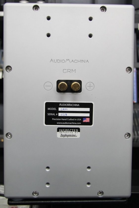

The AudioMachina CRM is only 6" deep (!) ?
Here is a photo of the rear panel
Steve

The AudioMachina CRM is only 6" deep (!) ?...
Steve
Wow, that is a small enclosure!  Metric spec is 15cm, or 2.4mm less than 6in.  The smaller the greater is rigidity.
