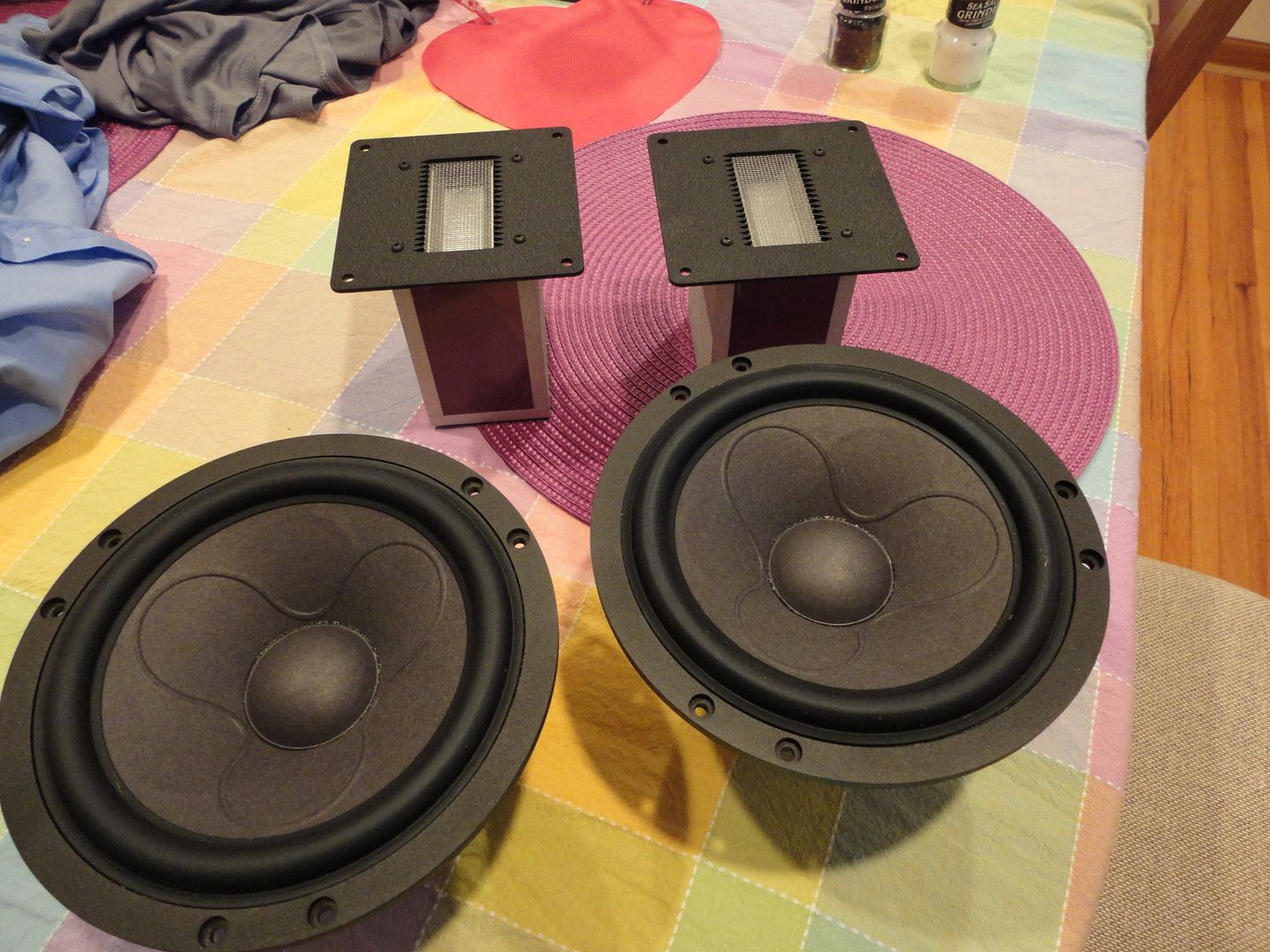

Material will be here tomorrow. I purchased 2 plates that measure 1"x8.5"x14". The total for two plates was $104.
Rick said he will be shipping the drivers out today or tomorrow :)
Can't wait!
Matt

Got a shipping notification last night, the drivers should be here Friday :)
Matt

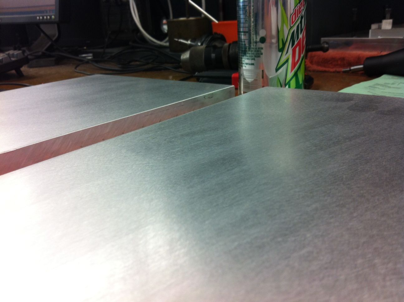

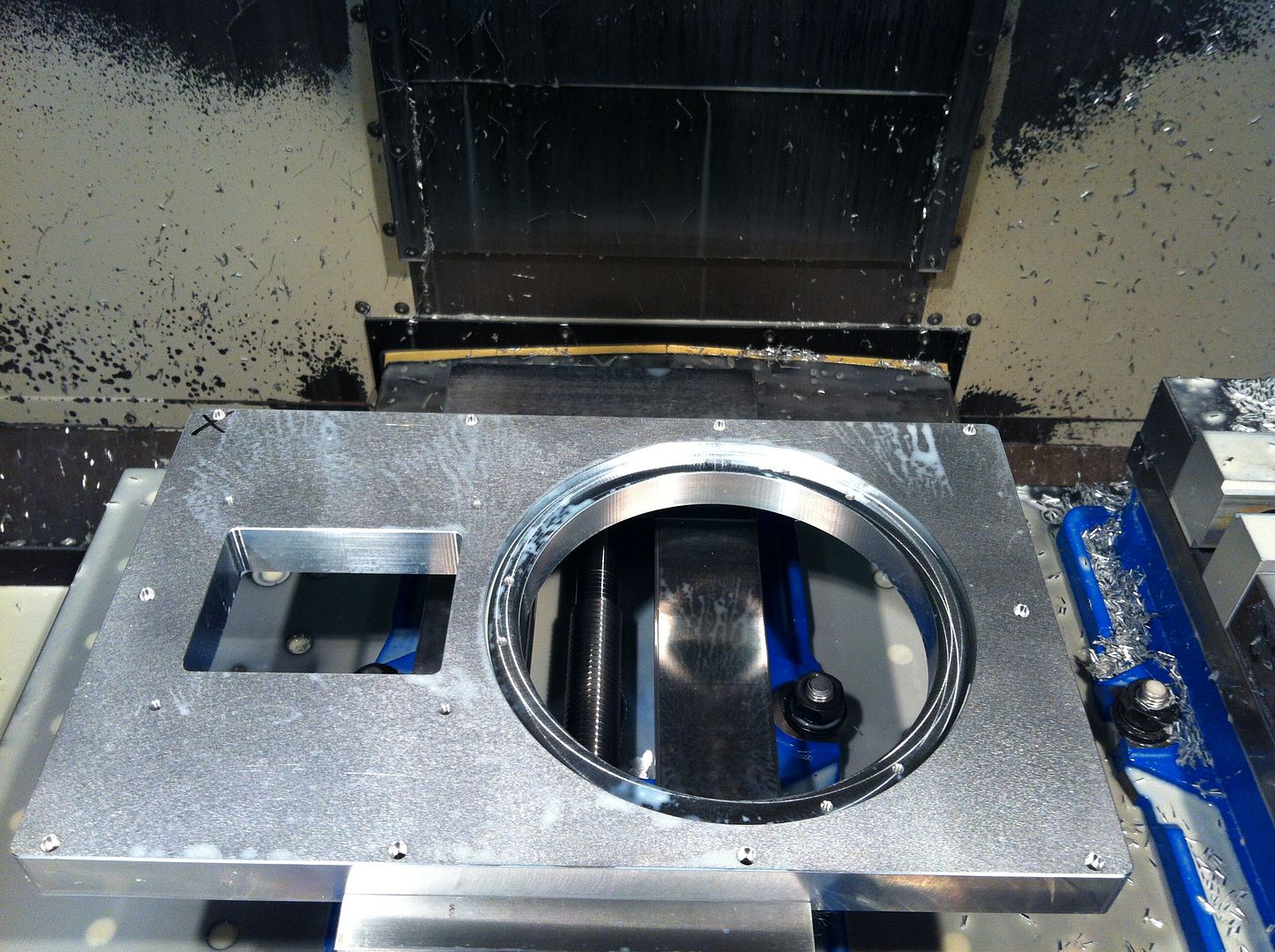

The material for the front baffles arrived this morning and some blocks for my custom NC400 cases  8)
MIC-6 aluminum comes with a protective plastic sheet to prevent transport scratches. It is naturally very shiny, not something i want.... So i used an orbital sander and made the finish more consistent with the rest of the speaker cabinets.
UPS shows the drivers should arrive Monday, that gives me time to bang out the amp cases people paid for.
Matt

Made the front baffles today. Tomorrow i will assemble everything and take my first listen :)
Started out milling the width down to 8.500"
Machined the length, cut the woofer and tweeter cutouts and drilled and tapped all the holes.
Flipped the part over, machined a 5/8" radius on the woofer cut out and added 1/4-20's for platters to rack on.
Matt

Kraemer,
Thanks for keeping us up to date. Are your Veritas sealed or ported? I don't think
you'll need any bracing, lol-
pawsman

Kraemer,
pawsman
Hi Paws,
They are sealed and no i definitely don't need any bracing  :green:
With 1" thick AL plate, it's more than rigid enough but with 3/4" on down, i would probably have added a cross member.
Matt

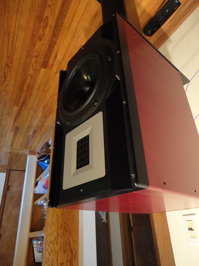

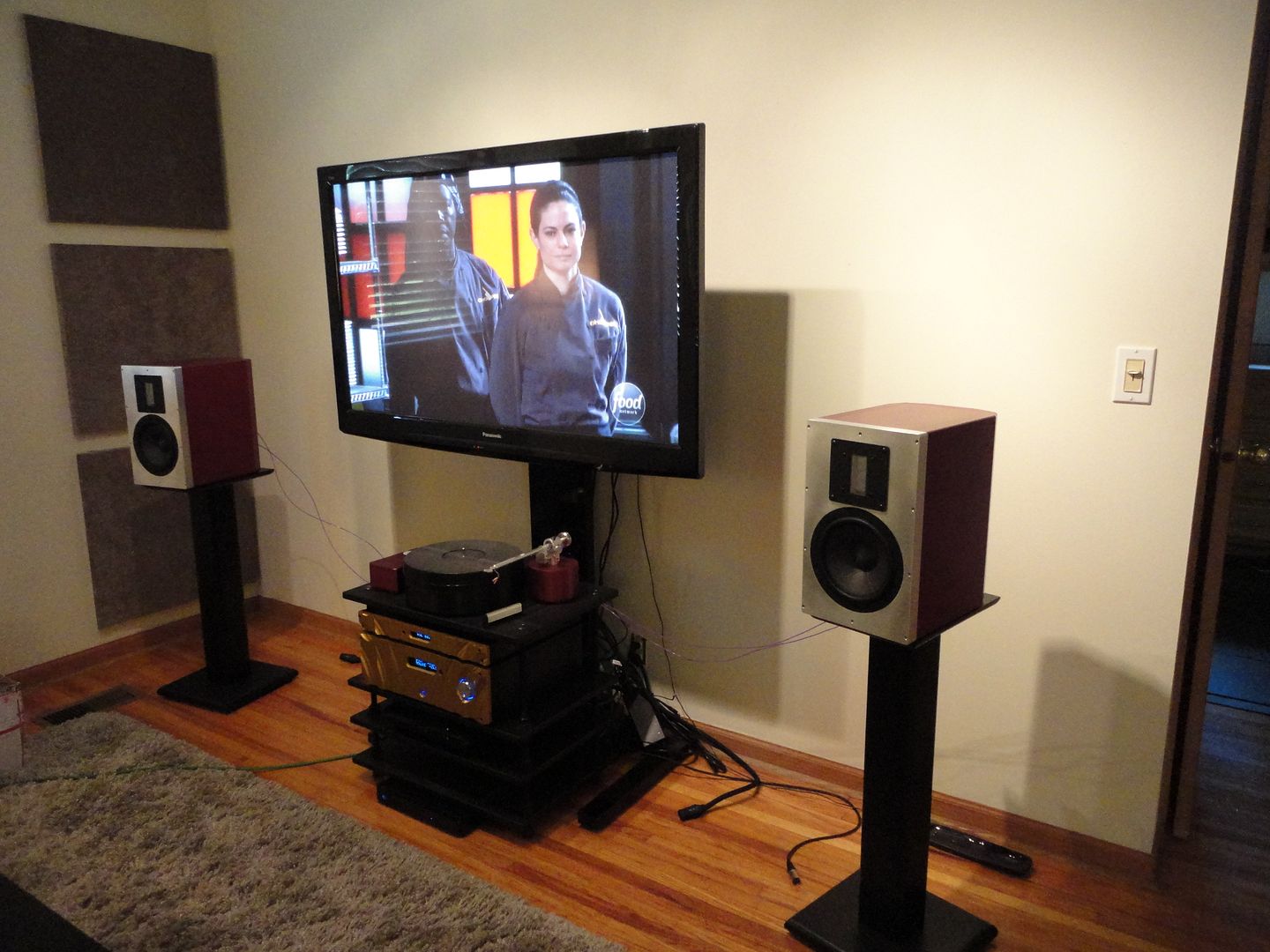

AluminatiSound
  • Posts: 485
  • Machining and Audio What A Great Match!
Re: Updating my GR n2x speakers to Selah Verita
« Reply #28 on: 18 Jun 2013, 11:47 pm »

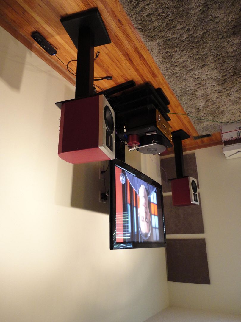

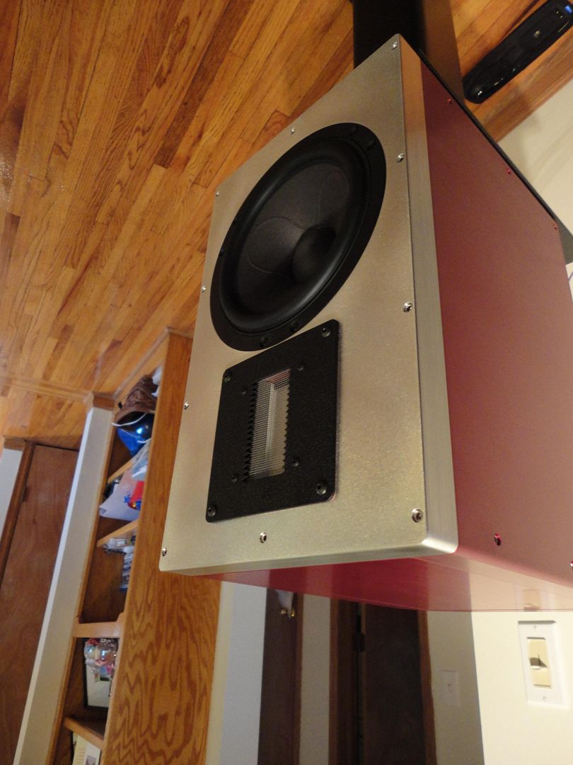

Got everything done today, minus the anodizing, which i will do in a few weeks, so i can let the speakers break in a little bit and to enjoy the sound :)
They went together great!!
Before with the GR Research N2X kit...
Now for the Selah Verita :)
I can't make a final say on which speaker is better because i have only been listening for an hour but i will no more as time comes. There is a definite level of detail that has increased and imaging is better.
Matt

matt,
impressive! have you thought using thinner alum but with a structured bracing inside? Magico does this, im not familiar with their speakers but many are impressed with their speakers.
cheers
henry

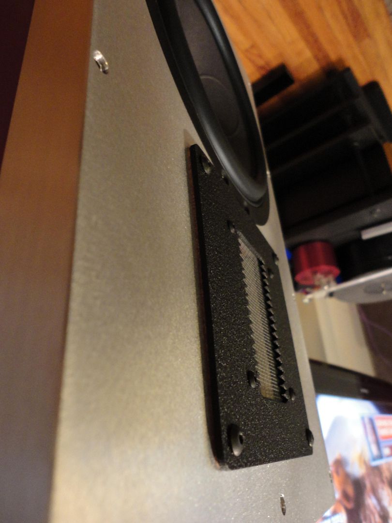

Jonathon Janusz
  • Posts: 908
« Reply #39 on: 19 Jun 2013, 01:34 am »
Matt, still very nice looking speakers!  Just wondering, since you could maybe do it before sending the baffles in to anno, how about a recess to flush mount the tweeter?  Might be splitting hairs, but it could be worth doing?
