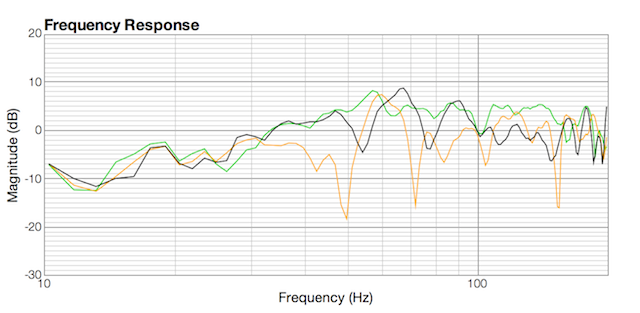

Hi, I'm not sure that the 3/6 dB fall-off with distance really holds at subwoofer frequencies (in a room). Here are some measurements that I took for a different purpose but may illustrate. I'm moving the sub away from the listener rather than the other way around, and all rooms are different so YMMV etc...
This is a monopole (sealed) sub at 1 (green), 2 (orange), and 3.3 (black) meters from the listener (right on the wall):
This is a dipole sub at 1 (green), 2 (orange), and 3.0 (black) meters from the listener (as close to the wall as possible):
I'd not looked at these measurements quite this way before, but this example suggests that the dipole tends to show the 6 dB/distance behavior, but the monopole doesn't. It also confirms that dipoles need to be kept away from the wall, but monopoles are better off right on the wall (if you can't put them next to the listening seat). In either case, room effects can swamp these generalizations (e.g. 50-90 Hz in this room).
I like putting dipole subs close to the LP. It solves so many problems in one fell swoop! From looking at your photo, Fred, if the subs need to be near the speakers I wonder if sealed subs behind them might not be the best way to go.
With regard to the line array of subs, it's been a while since I looked at it but as I recall you only need two drivers to satisfy the minimum spacing criterion i.e. at 25 and 75% of room height. But, you can't satisfy the line length criterion because the effective virtual length (3x ceiling height) isn't long enough anyway.
BTW, nice build Fred, I'm looking forward to hearing more about it :)
John R, thanks for the measurement data. Most people who don't have access to measurement equipment tend to underestimate the differential effect of the room on varying frequencies or the level change rate at various distances from the listener. One measurement will usually dispel any notion that the in-room response of any speaker will even remotely resemble the theoretical anechoic response.  :scratch:
The 3dB versus 6dB argument comes up almost every time I post a message about line arrays, especially where a point source driver will be combined with the array, such as the subwoofer with the DR912ad's or the Sweet 69's with their 12 woofers and one centrally positioned dome tweeter. In every instance I am warned about the dire consequences of combining a line array with a point source. In my case the in-room positions of the subwoofer, the line arrays and the listening chair never change, and I measure the frequency response, dial in the subwoofer level, and do the room correction with the mic set at the listening position. So the comments about the 3dB/6dB thing are theoretically correct but irrelevant in my situation.
