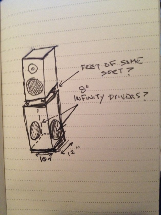

No, the idea is to make a pair of pedestal-type stands to match my speakers, and also build in subs to augment them. They will be driven by the 300 w plate amps in my SAM1s. The point is to spread the output around to three drivers, allowing greater clean SPLs in the bass. Here's a drawing (ignore the 'Infinity' reference for our purposes).
Do you have this setup sorted out electrically? You won't be able to just wire all three drivers in parallel, as the combined impedance will be too low for the amp. Certainly with the 4 ohm drivers you linked to. If you put two in series, and then parallel that with the internal SAM-1 driver, and if the SAM-1 driver is 8 ohms, then that will probably work. But if the driver sensitivities in this configuration aren't matched then it won't work well...
I can't help feeling that you'd be better off using separate amps. And larger drivers :)

Well  :scratch: I'm not really sure what you are trying to accomplish. I'm not saying that your idea can't be made to work, but it needs some careful investigation.
More likely to succeed would be to build enclosures as you suggest and use a separate amp to drive them. Optionally add a crossover/EQ.... however I wonder why not just make a separate sub. A pair of 10s or preferably 12s in a sealed enclosure would give you low-end heft and extension (possibly with some EQ).
You have a pair of solid state amps that aren't being used right now, right? So, you could use those to start with for the sub. For the crossover and EQ there's miniDSP, behringer, etc... Or, you could just use a plate amp with more limited EQ-ability.

The idea here is to reinforce the 8" subs in my monitors with additional subs to cover the same frequency range (20-200 Hz), allowing higher clean SPLs overall by allowing each sub/driver to do less for the same amount of volume. Within such a short distance, the drivers should act as a single bass source. It would also allow me to experiment with a distributed sub array, if I chose to separate the new subs from the SAMs and place them elsewhere, although my in-room bass response is pretty good already, save some dips between 100-200 hz. This is not a big problem I'm told, is probably floor bounce which we don't really hear, and I am also told that floor-coupled subs should take care of it.
So that's the story. Again, I am partial to the passive approach (driven from the SAM plate amps)  to start because it saves money and build complication. But my mind is open to other things, of course.

I am fairly certain that a front firing 8" driver - or dual opposed, front and back - would be no problem, seeing as my speakers of equal baffle width use 8" subs.
Doing a side firing array would allow the use of 10" drivers, so there's that. Also, I think I might prefer the look of a side firing array, so that I avoid different looking drivers arrayed together, but it's a secondary consideration. One issue is the mounting depth required for side firing dual opposed drivers, as I only have 10" to work with. Although I guess there's no real reason I couldn't expand the width of the sub-stands a bit to accommodate.
