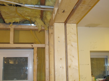

Next up: framing and electrical.
New dedicated 20-amp lines for the stereo. Also notice the isolation bars between the joists and framed wall.  The floor of the upstairs is decoupled from the ceiling of the music room.  No footfalls from above will be heard in the listening room. Vibrations from sound waves in the listening room will not be felt or heard upstairs.
The walls of the listening room will be suspended from, but not directly connected to the joists above. Neoprene bushings in the clips separate the studs from the joists.
Double-wall construction helps isolate the listening room from the rest of the house.
The original metal ducts are replaced by flexible, insulated ducts.  One more source of unwanted noise is gone.
A soffit is built around the central duct.  This duct is now insulated on all sides.  The soffit will be also be lightly packed with insulation before being drywalled.
Framing is almost completed!

Another tip for you:  provide an isolated ground to the third pin of your electrical plugs.  Drive a couple or maybe even three of six foot copper rods into the earth, couple all together with #6 stranded copper to a centrally located buss bar to distribute individually to your plugs.  This will help increase your signal to noise ratio and provide a silent electronic background for the music.  The common ground in your house carries a lot of junk signals which manifest themselves in a bad way on your sound.  Another good thing is an AC regenerator.  These have fallen in price, and provide ripple free symmetrical power to your equipment.  These mods would qualify your AC as "tech power".  A wonderful thing!

Looks to be a well thought out and well governed project.   I just finished the basement in our house this winter, and did some of what you are doing.  I was not going the whole 9 yards for sound transmission reduction though, just Safe n Sound in the ceiling and all interior walls, insulated around all the drains with same, and had a pony panel installed for the dedicated AC lines.
I also installed a SnS door at the entry to the room.
When I stuffed my bulkhead/soffit, I just used pink rather than the SnS insulation.  It did just fine for that, it masks the sound of my HVAC trunk well.  Not perfect, but decent.
I can listen after bedtime down there louder than I normally would, with no complaints so far.

A lot of progress and a setback this week.
The soffit is built for the flexible air ducts and air return.  The ceiling height will be 6'2" under the soffit.  I think Tyler is about 5'10".
The room is framed, wired, insulated, and ready for inspection. The man in the foreground is Greg Morgan. He's the go-to-guy in northern Virginia for sound isolation construction.
The ceiling of the listening room is suspended from the floor joists above with isolation clips. You can see one to the right of the blue outlet box.
Here's the trouble spot. The building inspector failed the room for lack of fire egress. I guess the inspector thinks me and my heavy friends might have difficulty climbing out that window.  :lol:
So, it took a day to dig out a much bigger window well, expand the egress, and install the new window.
The new egress window is installed and we're back on track for inspection before the walls go up.  This window is only 36" up from the floor and it's 48" high. You can see the ladder inside the window well, too. Now that is a safe window.

Hopefully that's a drain line for the window well below the egress window, especially with the flooding you mentioned.  Another good tip for avoiding flooding is to slope all the ground away from the house and install 4 inch drain tile to your downspouts and run them away from the house.
For the finished basement we built 9 years ago (in heavy clay) I used 2 foot roof overhangs throughout, footing tile that drain (by gravity plus code required sump/pump) away from the house, tar coated/poured concrete walls, pea stone backfill, landscaping stones/fabric throughout, sloped everything away from the house, and tiled all the downspouts away from the house.

Yes, there's a drain line for the egress window.  It's the white pipe below the window that feeds the french drain to the sump pump.  Belt and suspenders!  We also replaced all the gutters and downspouts and splash blocks.  Just regraded the ground away from the house.  The electrical grounding gets done this weekend.
