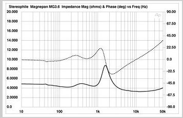

The issue is that low bass usually dips down to 2ohms and even to 1 in some instances.  Tube amps are adept at handling low ohm loads, but even then, can be taxing.   SS or Class D can compensate for this to some extent with more wattage.
Jim
Huh?  Jim, I don't know where you come up with this stuff.  :)
The DC resistance represents the lowest impedance of a transducer frequency range, but only a very few speakers have impedance's in that low of range.  Apogee Scintilla, Full-range, etc.
Maggies certainly don't.  They're generally at/near 4 ohms throughout their frequency range.  Only the crossover network yields peaks in the system impedance of Magnepan's.
Dave.
ehider
Re: What if Magnepan went to an active bass panel?
« Reply #25 on: 18 May 2013, 02:05 am »
Having myself owned two different Maggies, I would absolutely agree with Dave that Maggies do NOT droop in their impedance whatsoever at the lowest frequencies or any other frequencies for that matter (see chart below of 3.6 model's impedance measurement from 10 hz to 50khz).
That's been my understanding as well - i.e. that maggies while a 4 ohm load, tend to be a pretty flat 4 ohms across the frequency range, which your chart demonstrates. I.e. they don't have wild impedance swings like some speakers. This sort of refutes claims of massive power needed for maggies.  You just need something that can produce a reasonable & consistent power to a 4 ohm load. More power might give you more headroom - though only as far as the physical constraints of maggies - i.e. mylar / QR / whatever slapping magnets.

The magnitude (and flatness) of the Magnepan impedance swings is not really related (directly) to the power requirement.  They DO need a lot (some might say "massive") of power, but it's because of the very low acoustic efficiency of the transducers and not the impedance load.
I've seen some refer to Maggies as an "easy" load for an amplifier.  This is partially true, but only in one context.  :)
