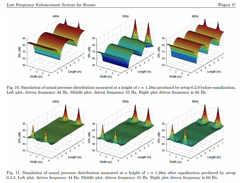

*Scotty*
Since you have already have two full range speakers in the ZU Definition Mk.IV with a low frequency response of 14Hz., you don't need sub-woofers beside your main speakers at the front of the room. The primary problem which causes uneven bass response in your room is the reflection of bass energy from the wall behind you which collides with the bass radiated from the front speakers causing standing waves.
 With the addition of two subs to the full range loudspeakers you already have you are in an idea position to implement a four sub system. By placing the two additional subs you have at the back of the room behind you and operating them out of phase with your main speakers you have a chance to cancel out the bass energy from the front speakers before it can impact on the rear wall and reflect back towards the front of the room and interfere with the bass emitted by the front speakers.
See image below
Here is a link to the complete paper the the above image was sourced from.
http://vbn.aau.dk/files/12831869/AC-phd.pdf
All you will need to try this out is some inexpensive ICs long enough to reach the subs in the back of the room. Don't place the subs in the corners back there, rather space them at one third the distance from corners of the room along the wall or roughly the same distance apart as your front mains. Your problems with standing waves in the room are going to start at about 125Hz,depending on the subs crossover slope you may want set it between 60Hz and 80Hz, my subs have a 12dB/oct slope and I run mine at about 60Hz.
Have fun, you may also notice a substantial improvement in the imaging the system has when you reduce the amount of standing waves in room.
Run the subs in stereo, left channel to left rear  sub, right channel to right rear sub.
Scotty

*Scotty*
David, the same basic advice applies, try putting one sub in mono in the front between the satellites and one in the rear on the back wall out of phase. Match the crossover points on the subs on the front and the rear. No guarantees that you will like the setup but you should have considerably flatter response in the room than you might have with the two subs in the front augmenting the output of the front mains.
Scotty
*Scotty*
Maxcast, you may or may not see an increase in total bass energy in the room. There is usually room gain adding to the bass output of the full range speakers below the room's Schroeder frequency, the out of phase bass energy from the subs in the rear helps to counter act the room gain to a degree.
 The key thing to remember is that you are not running the rear subs at the same level as the front mains. What you are trying to do is cancel out the energy that remains that could be reflected by the rear wall after losses due to transmission through the rooms walls and any absorption that might have taken place.
 Typically you can't tell the rear sub is even operating unless you are right next to it if the levels are set correctly. When everything works right the bass gradually diminishes as you approach the rear of the room until it is virtually gone. However at the listening position you have the full bass energy required by the source material for proper reproduction.
Scotty
