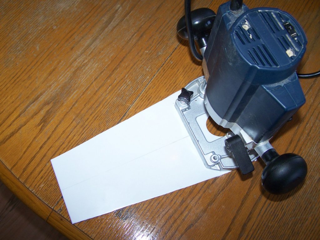

There has been are a lot of great ideas already presented by those with a lot more knowledge than me, but what worked great for me was my homemade jig.
 Just made my own from masonite. The center pin is an 1/8" drill bit the jig swings around. I just measured the radius from the far edge of the router bit to the center of the pivot pin hole. with a caliper. I drilled the hole in the jig with a brad point drill to get an exact center. It works PERFECT!!
 One tweeter counter bore was just a few thousandths under size, so I opened the hole in the jig a tiny bit with a larger drill bit.
I just held the jig tightly against the pivot pin. The new slightly larger hole allowed the counterbore to increase a few thousandths.

Made my own as well.....worked slick.
I used the heck out of this on my round super v build.....never missed a beat

I did the same as Lacro and PDR. Worked great for me. I suggested the over and undersize endmills since you already own a jig in 1/16" increments. The tool bit in the router pic is a .500 carbide 4 flute center cutting endmill. The center fixture pin is an 1/8" steel dowel.

I made my own for an AV 1 build and am making my own for an xls and sealed sub build. Couple practice cuts on scrap and careful measurements i was on my way. Particularly fun for me because i am not a seasoned woodworker. Made the build go at a slow pace, which i wanted, and left me with some diy accomplishment!!

Thanks a lot for all the suggestions. I found the jig from Parts Express and ordered it. I like the idea of using end mills also. It seems that a 4 flute endmill would make a smoother cut than a 2 flute straight bit.
Thanks for the ideas on making my own jigs. I have hardboard laying around the garage and 2 routers, the larger size with a circular base (though it's currently in the router table) and a smaller trim router with the square base.
