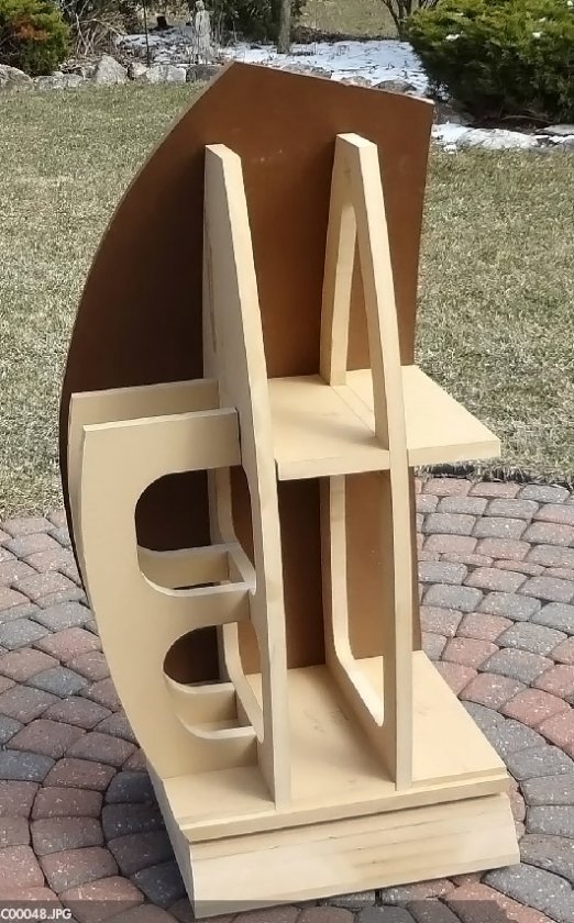

Here's a nice shot of the internal bracing.  The walls are already thick pre-tensioned panels, and covered inside with our 'inversion layer', so the bracing is overkill ... but that's what we do.
Re: Nimbus
« Reply #28 on: 3 May 2013, 02:07 am »
