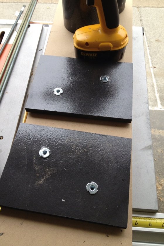

I used a table saw to cut the top and bottom parts.  The 3/4 inch top ( you could use 1/2 too) is going to be just smaller than the bottom of an Encore speaker.  The bottom will be 12x13 inches or similar in proportions to the top.  You could use a circular saw with a straight edge or even a jig saw with a straight edge.
The bottom will be two pieces glued together to make it 1.5 inches thick and allow for the speaker spikes if needed.  I put the table saw at 30 degrees and cut every edge to make them all look beveled on the sides.
I drilled two holes in the top plate to accept the T nut which will hold the rod in place at the top and you can assemble from the bottom-as well as add sand later or lead shot.
I drilled two holes in the bottom plates too.  I counter sunk with a spade bit so you would not see the bolt on the bottom.  I layed the top part over the bottom to sync of the screw/bolt holes too.

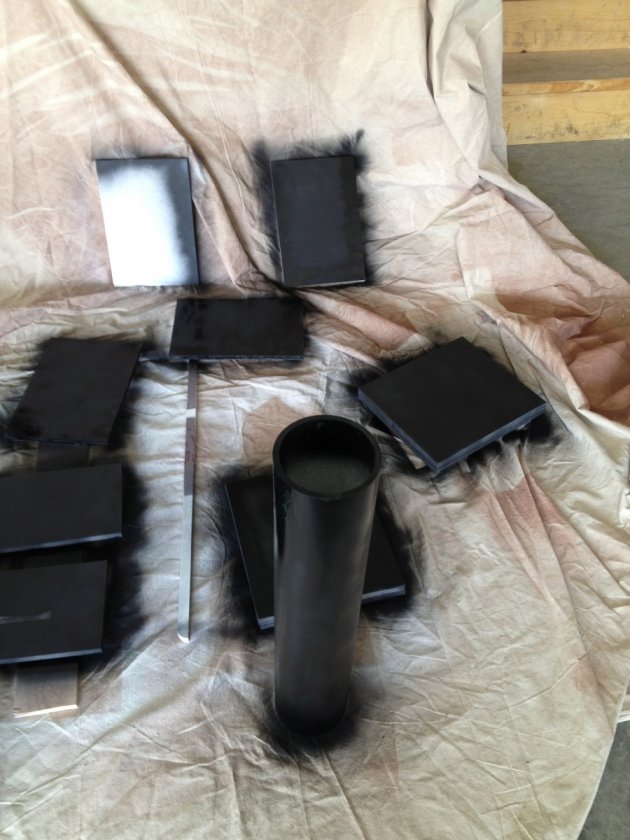

« Reply #3 on: 10 Apr 2013, 05:40 pm »

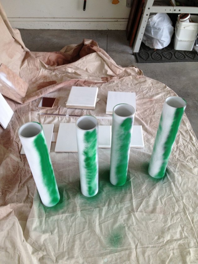

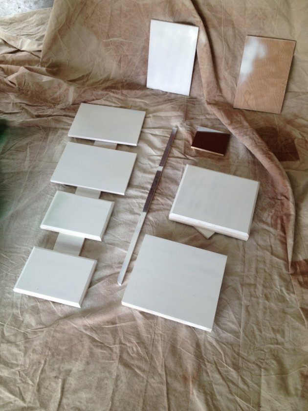

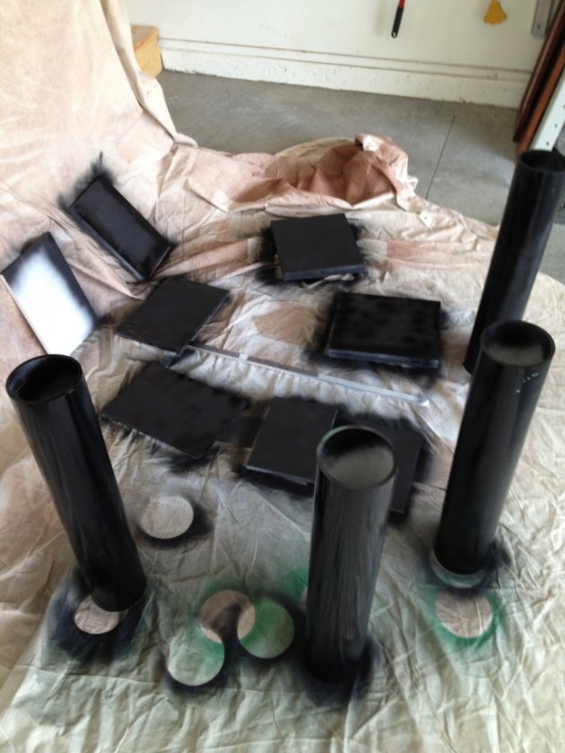

I sanded all the edges with a sander, but you can easily do this by hand.  I primed them all white, and then had some extra Green Bay Packer paint to see if it would stick to the PVC without roughing the PVC up.  It did not and I had to scruff the PVC some more even though the primer was built for PVC
jparkhur
Re: Encore XLS Stands for DUMMIES

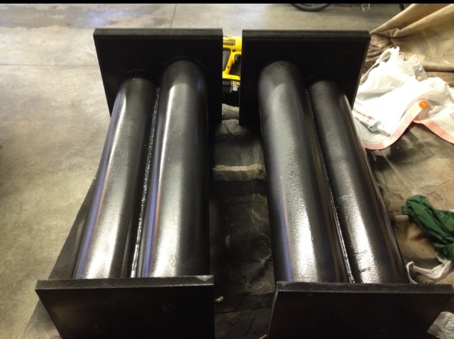

« Reply #4 on: 10 Apr 2013, 05:44 pm »

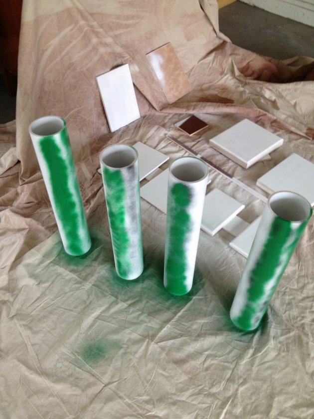

Tried to paint everything black and glued the two pvc tubes together for the look I wanted.  I used some left over gorilla glue, did not work.. I expanded out and should have used regular glue.  I had to chip away at it in the middle and then to make I look better I ran a bead of paintable caulk over the joint and pushed it in with my finger to make it appear smooth.  I will never notice it once it is all done.  Some of the paint ran on the sides, i'll have to touch up in the end. Also, when I glued them together, I laid them flat on the ground and then clamped them on the ends to keep them from moving.

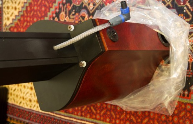

I may include or steal the Vapor Idea for the T Bolts on the bottom of the speakers and stands to hold them on.  I figure with littles running around it maybe needed.  Similar to the ones here:   Would be an easy drill insert and threaded T bold

« Reply #9 on: 12 Apr 2013, 12:30 am »
Here are the T nuts for the top. I thought they had stops on them they don't so the rod keeps going though.  I will fill them with lead or sand.

« Reply #12 on: 19 Apr 2013, 12:28 am »

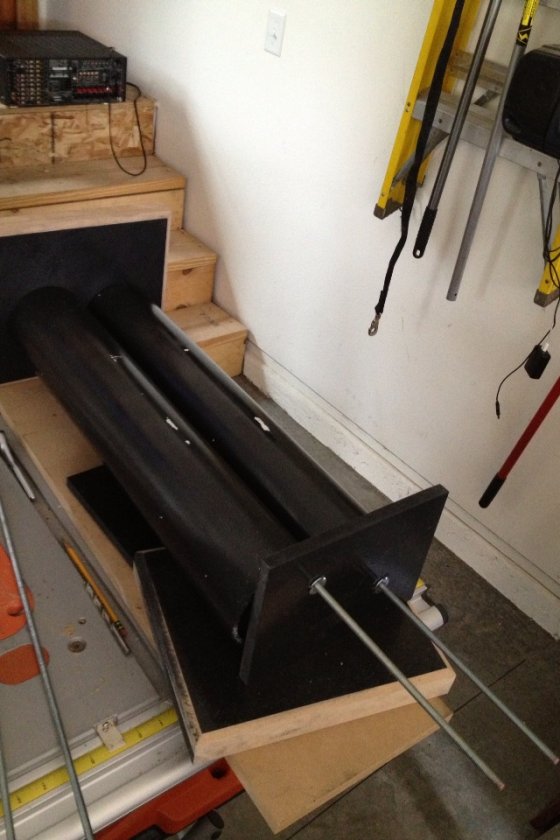

Bolts on both ends and footer plugs in
I off set them for a different look and would use just one pipe in the future.

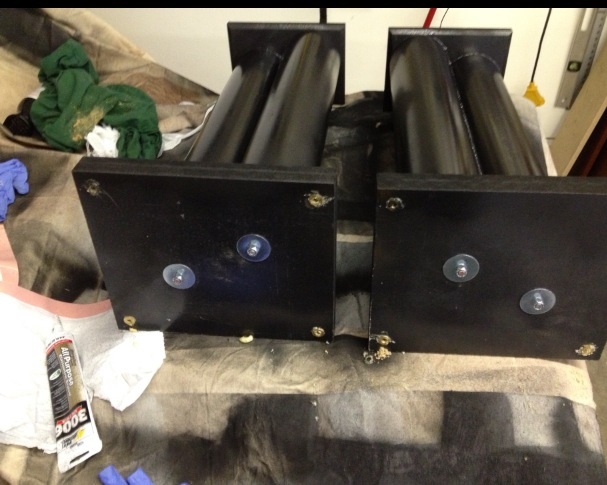

I woke up to this in the morning.  Gorilla glue is not the best to use on the spike insert. It expanded in to the threads so I had to buy new ones at hardware store - not good. I had to re prime the Mdf edges as the did not like the spray primer at all.  Last coat of hammered black should go on today if the garage heater kicks in.

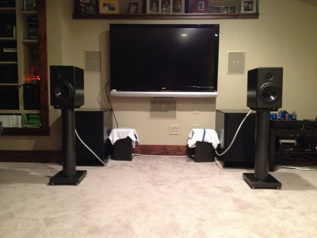

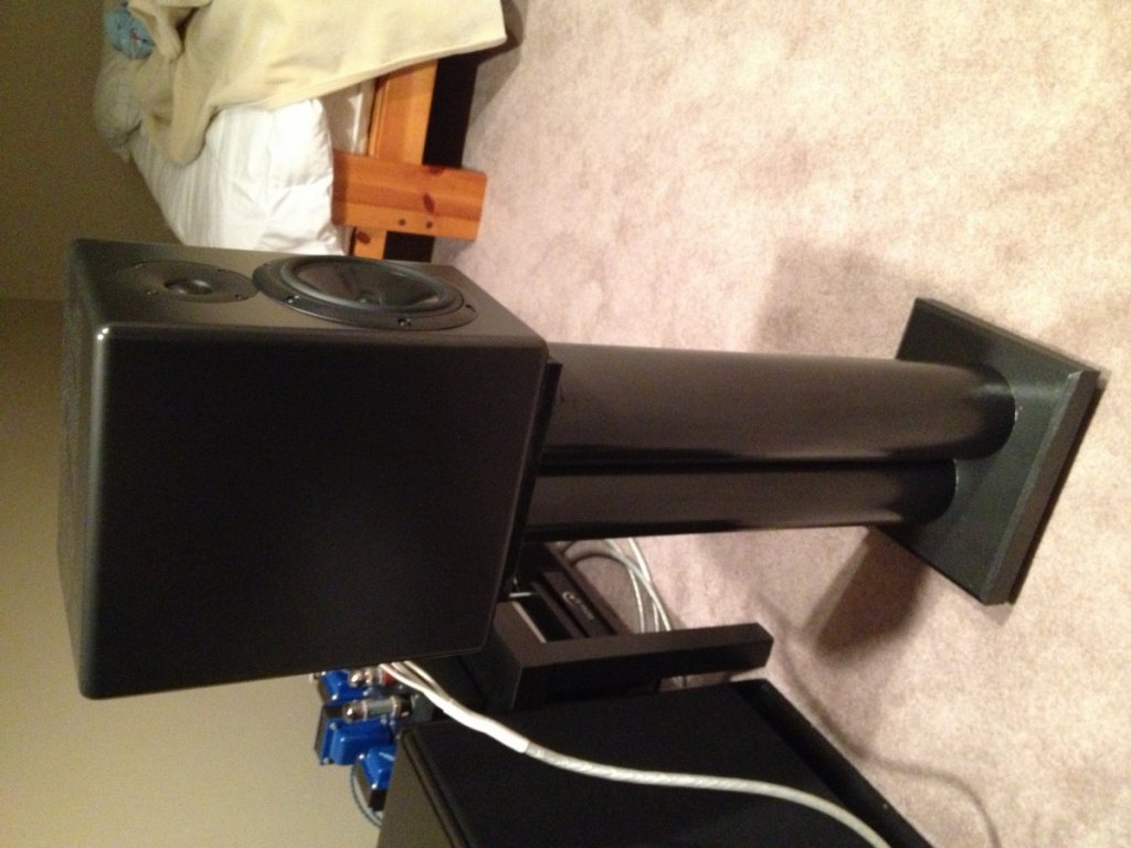

« Reply #14 on: 24 Apr 2013, 01:20 am »
Done, filled with sand three quarters of way up from an insert hole on top. Color is hammered black, off set pipes for my screw up on top plate size and finished with a set of chrome spikes from GR Reasearch.  The speakers on top are the super duper sale kit with grossly upgraded xo's ( that was my thing- I could have just done the bypass like Danny said- more cost effective but?). The speakers are a gun metal satin.

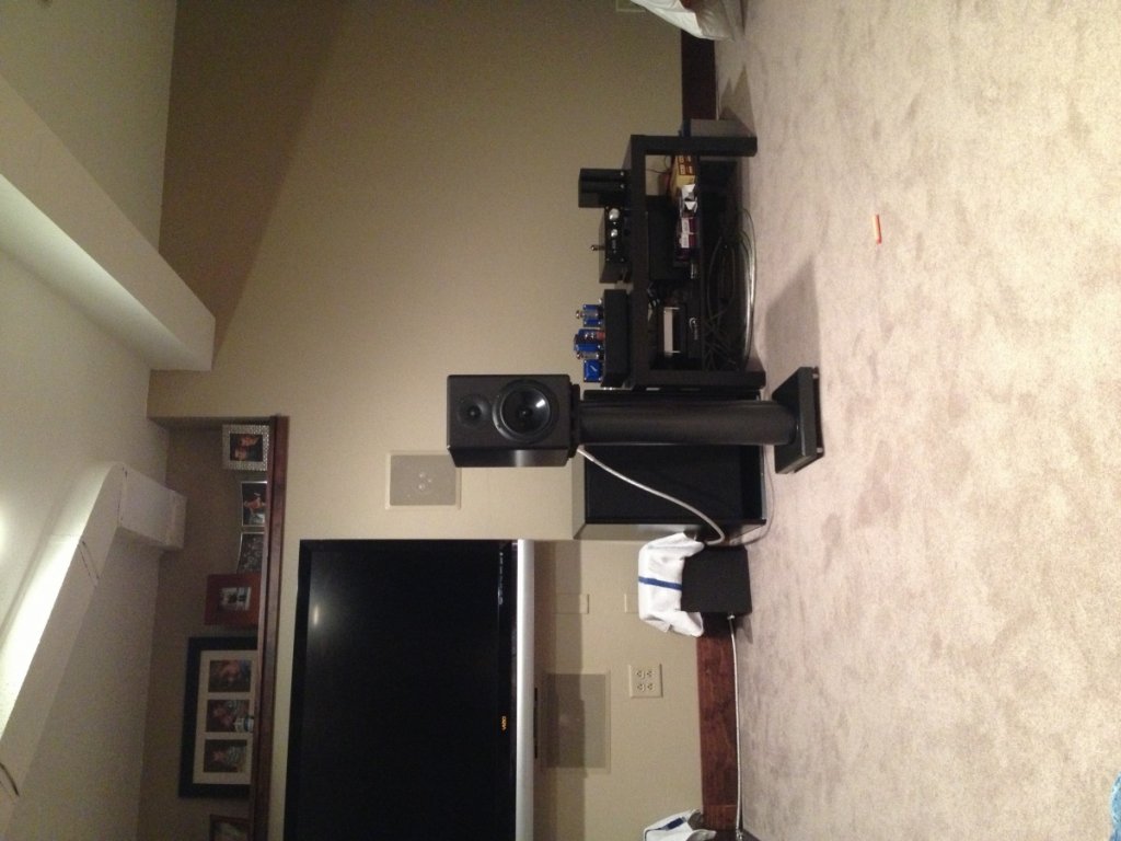

« Reply #15 on: 24 Apr 2013, 01:22 am »
Pulling the xls encores out from the wall actually helped with imaging and soundstage.  Great little speaker.
