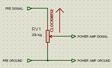

The problem is complicated by the fact that you may want to set different balance points at different listening levels.
Perhaps the most straightforward way to implement this is a way of allowing you to turn down one channel by a variable amount.
This will avoid most complications such as increased crosstalk or noise.
Just get a single 20k logarithmic pot and wire it into the side that is too loud. Then you can turn that side down...
I chose the value to fit with your system. This is absolutely the most transparent solution other than using a pair of resistors, which obviously won't be adjustable. You can use a stepped attenuator if you want.
If you use a conventional balance control it will introduce an overall loss, or you'll need some amplification (and a power supply) and it will push up the crosstalk, possibly introduce some noise if not correctly designed.

Re: DIY balance control
« Reply #8 on: 5 Apr 2013, 11:06 pm »
Yes. The general rule is that for audio, impedances should be stepped by a factor of 10. Therefore your pre should see 5 ohms minimum and your PA should be driven from 20k maximum.
For these reasons I suggested a 20k pot or switched attenuator. The pre will drive more cleanly into a higher value. You could just choose not to populate the switched attenuator with the greater attenuations.

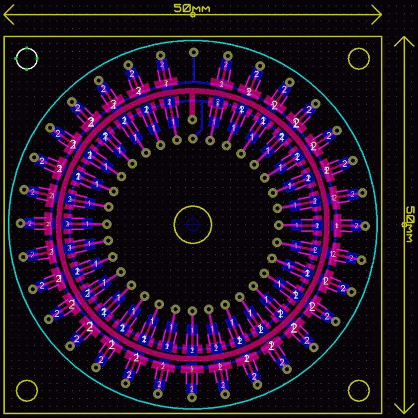

Alps are good pots. Watch out for fakes. The Blore Edwards Type 72 30-way switch is good.
If you can find somebody to supply one.
http://www.blore-ed.com/products/index.php?title=Type_72
Populate it with 1206 thin-film (metal-film) resistors which fit exactly. Vishay are good, you can get quite a few values off-the-shelf from Farnell.
w

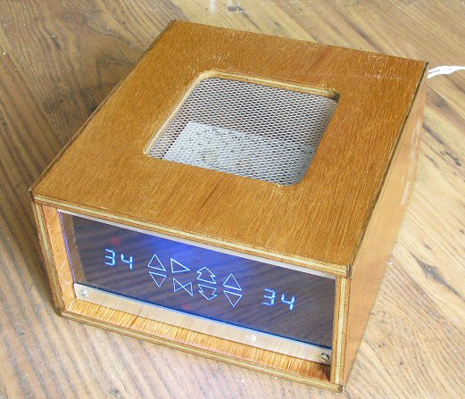

I've got this relay-switched remote/touchsense passive preamp I designed...
...and I'm working on this stepper-motor operated version, which will be a lot more compact.
I'm waiting to take delivery of a CNC mill, which will make it easier to produce, and result in a more professional looking item.   :thumb:
...but I wasn't going to mention those  :green:
w
Oh do tell more. What price points to you envision for example?
