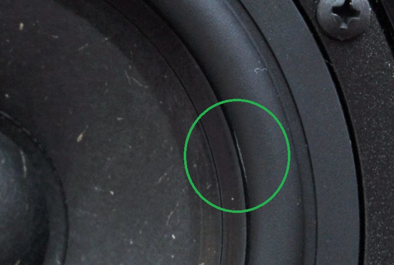

I uploaded some high resolution photos here which show speaker placement (the speaker on the left is the one with the issue), and a closeup of each driver:
http://webspace.lenscritic.com/songtowers/

My eyes aren't what they used to be but it sure looks like there's a crack in the surround in the 3rd photo (DSC_1961.jpg) at about 2:30 o'clock.
Whatever the problem is, I'm sure Jim will take care of you in short order.
Good Luck.
It looks like a split to me also.
Either way, spider or surround (or both), it's a woofer replacement.

On closer inspection I'm pretty sure that's just a mark. I don't see any separation including if I push woofer very gently with my hand. Not sure how else to inspect it. I don't want to damage anything.
Jim, I'll IM you soon to set up a time to chat.
Thanks!

So I think I narrowed it down to a specific woofer by placing my ear right next to the top woofer and then the bottom woofer (while the same section of track was playing). The difference is very noticeable, which I found surprising given the close proximity. The woofer that seems problematic was the one with the mark in photo, but as I said it really doesn't appear to be a tear on close inspection.
