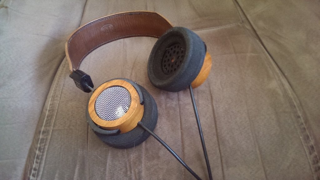

I was given some Grado SR125's a few years back and changed everything but the skeleton......
There is a post/thread/small book here somewhere that follows the modding.... Buy an old used pair and have a ball.  My ear chambers are Limba wood,  I tried coco...??? (sp) and several others before settling for Limba... Violins,  and other older classical instruments are built in limba. They sound great,  I still have them,  they will never be sold the whole process was a blast!!!!!!!
 I'll try and locate the thread..... Have fun.... Enjoy!!!
