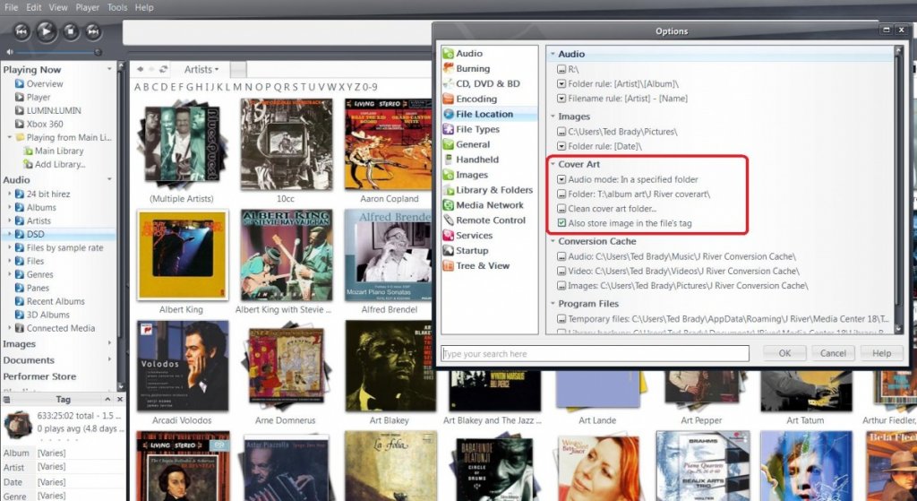

ted_b
  • Posts: 6345
Re: dff files not importing into j river
« Reply #19 on: 18 Mar 2013, 08:52 pm »
I would say that 90% of my DSF extractions have cover art already in place via JRiver.  I have JRiver's coverart settings at basic defaults.
Here is a DSD custom view, with my cover art settings
