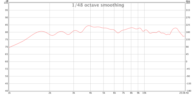

« Reply #13 on: 14 Sep 2013, 02:38 pm »
And here's the TPL with the widest baffles (not much difference to the thinnest baffle).

JohnR
Re: Planning an MTM build with BetsyWOW and TPL-150(H)
« Reply #18 on: 17 Sep 2013, 11:49 am »

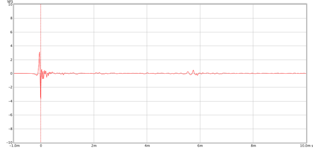

Unsmooth the measurement, then click on 'IR Windows" and set the "Right Window" to 2 ms. Going back to the SPL window, this is the result:
Why 2 ms? Go to the Impulse Response window, set the dropdown selector to %FS and adjust the scales, you can see that the first reflection is a little after 2 ms:
