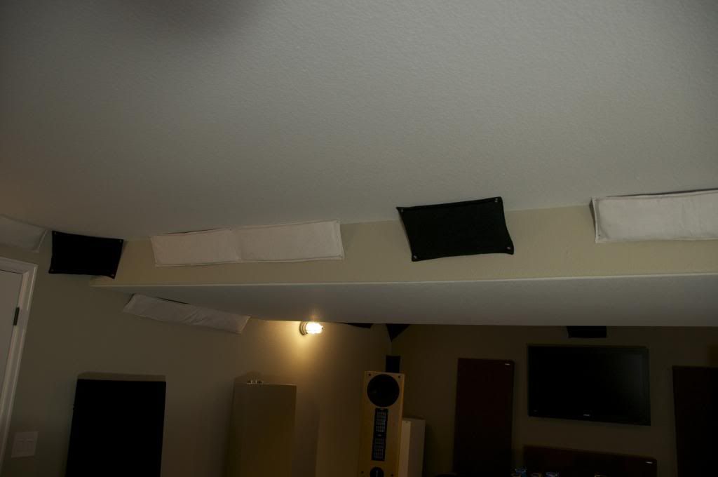

Hat channel through the ceiling to decouple floor joists from ceiling drywall.
Completely rebuilt all air return and supplies to use fiberboard and insulated slinky tube to eliminate vent borne noise pollution.
double drywall on ceiling with green glue

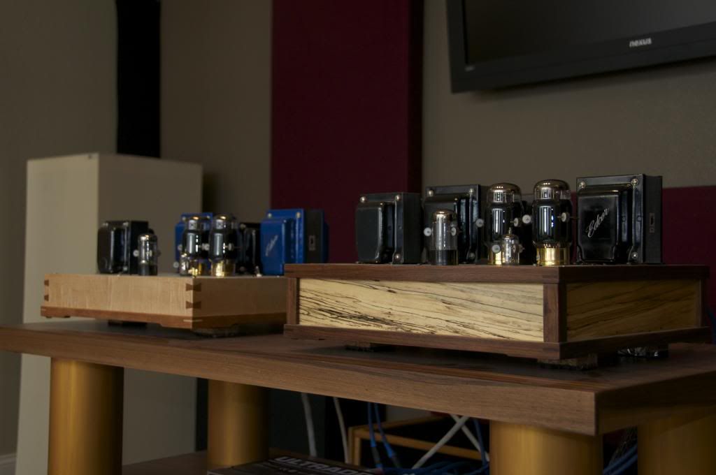

Amps- Homemade Simple SE SET amps (here for more details http://www.audiocircle.com/index.php?topic=73713.20 ) and QSC dca 1222

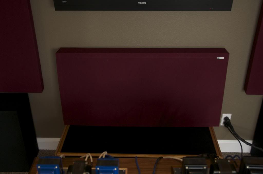

room treatment- GIK acoustics 242 x5, 244 x3, monster traps x 3, soffit traps x 3, scopus T40 membrane bass traps x6 (BIG shout out to Bryan for his immense knowledge and infinite patience!!!), various 8th nerve corner and seam treatments. Home made window well stuffers to blot out light and provide a bit of absorbtion.

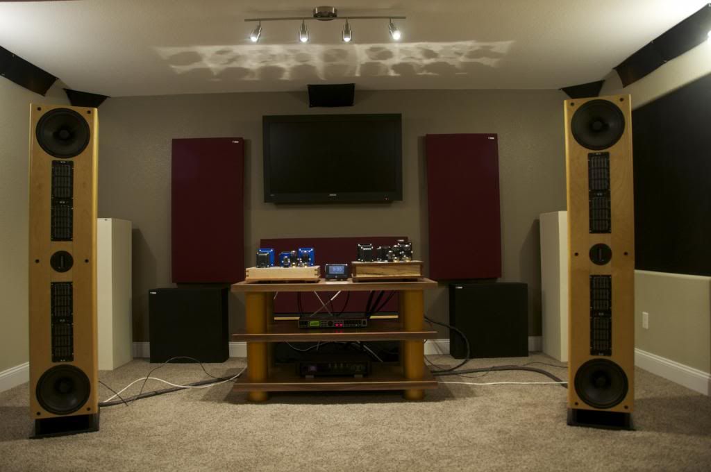

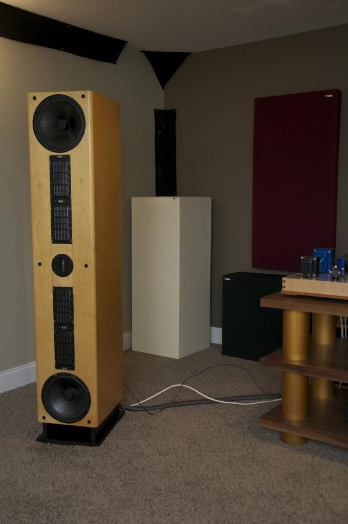

Front of the room

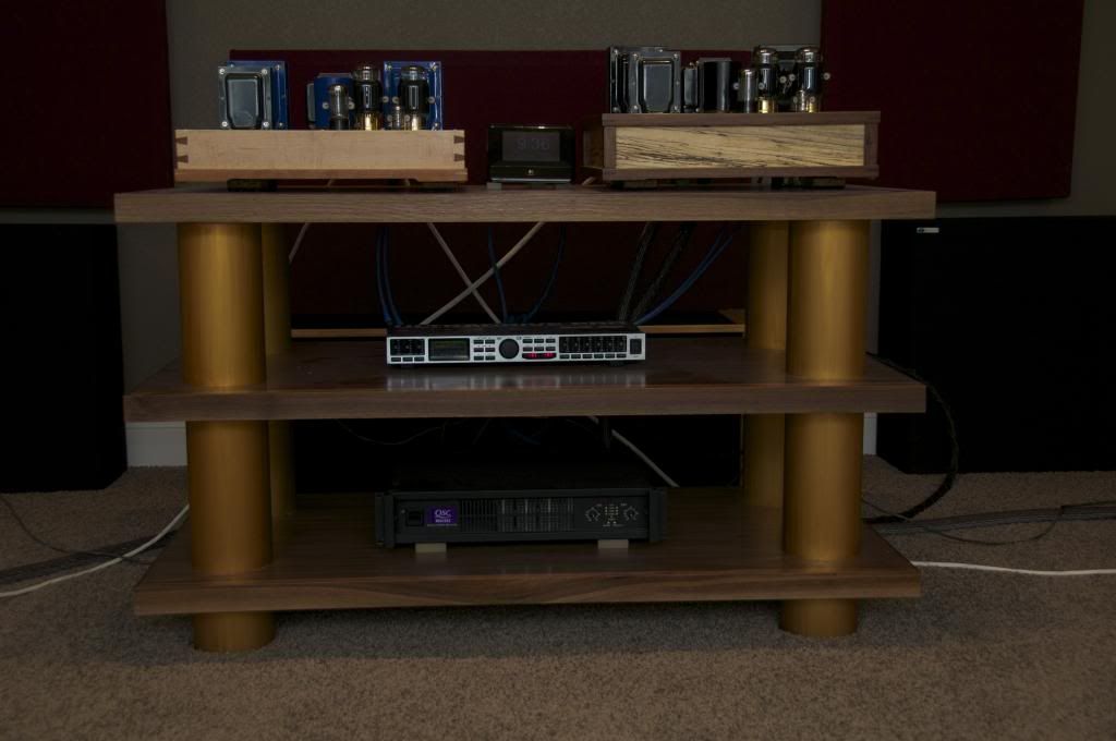

equipment rack
Sexy sexy amps!

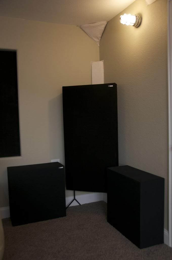

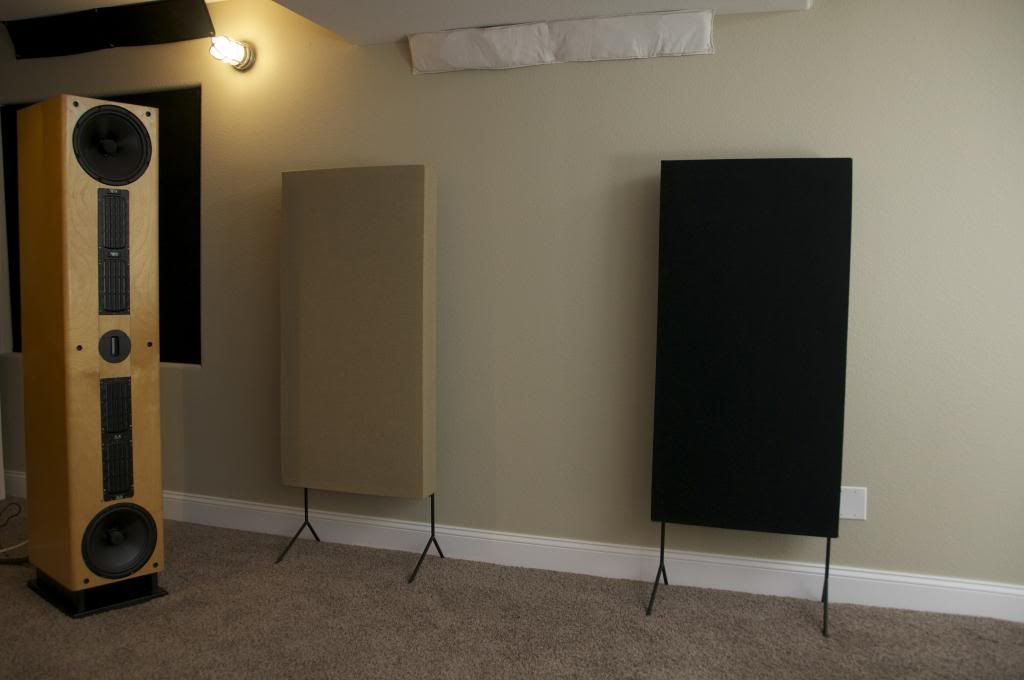

side
Behind speaker
behind rack

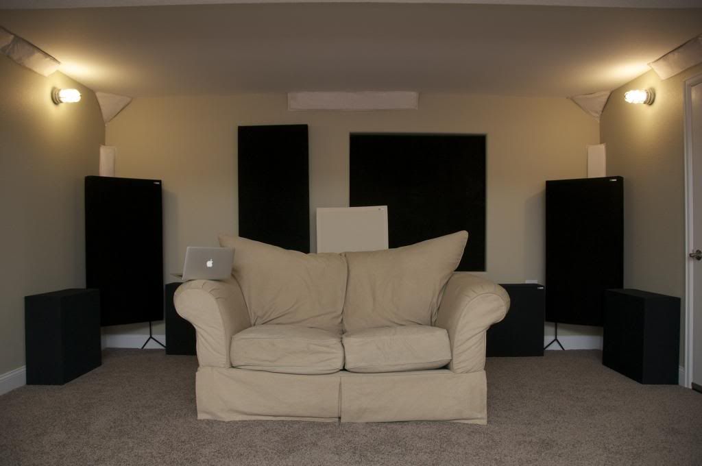

rear room/sitting position
bass problems don't stand a chance!!!
Neither does slap echo and corner issues.

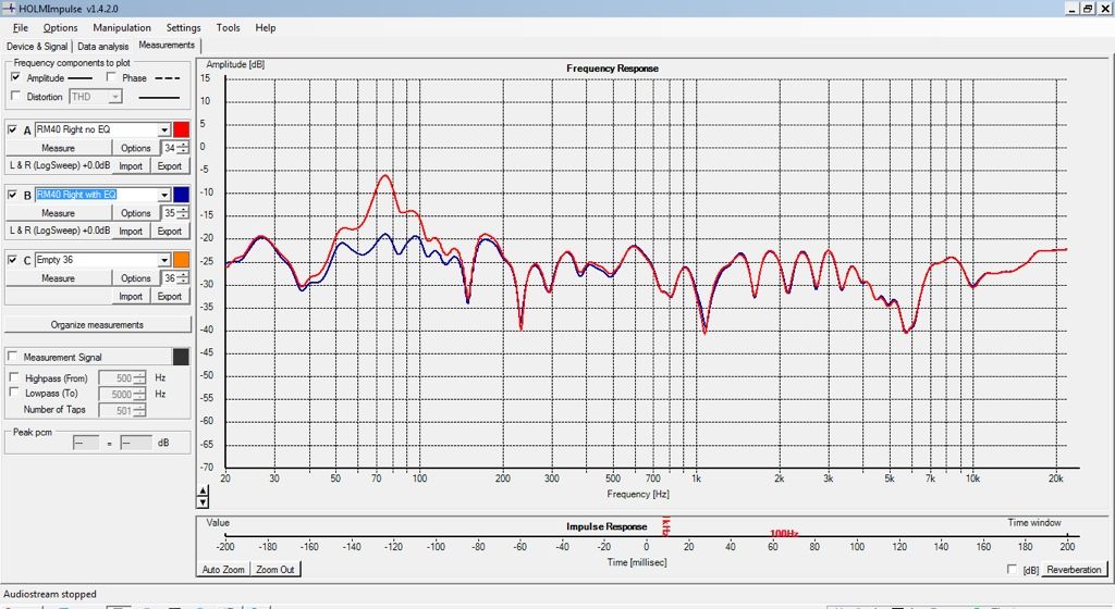

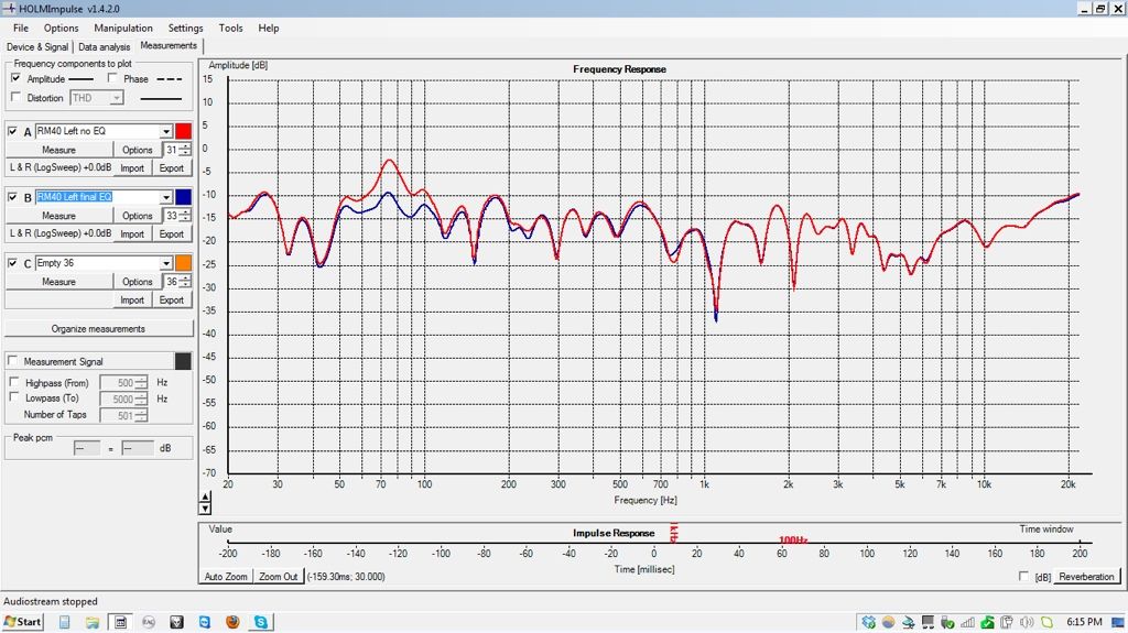

So what about music? Well Tyson was kind enough to come over yesterday with his calibrated mic and we took the following measurements from the listening position.
so as usual with 8 foot ceilings there was an issue at 70ish hz The red line shows the un-EQ'd results, blue is EQ'd the left speaker started out with a -6dB @ 75hz adjustment, but we ended up being much more aggressive with a -14dB change. The slight rise from around 10kHz up was adjusted for later, but we forgot to get measurements for.
After some tweaking and doing the ritualistic audiophile shuffle of moving the listening position, bringing speakers forward/back/adjusting toe-in we finally got to a spot where it was just... Jaw dropping. Gorgeous even! I can honestly say the results far exceeded my expectations in almost every way. Imaging and soundstage have always been a focal point to me. And boy does excel at that! it is unsettling how pinpoint it is. as far as soundstaging I think my wife said it best when she said 'it doesn't even sound like anything is coming out of the speakers, even though intellectually I know that's where the sound is coming from, it sounds like the music is coming from all around.'  :o

The thing that struck me when listening to music (before doing any EQ) was that the bass was too heavy but otherwise sounded very promising!  Up went the calibrated mic and the laptop with the HOLM Impulse software and started to run sweeps.  The room only had one bass node at 75hz and it was consistent for each speaker.  This tells me that the bass traps were working at removing front to back and side to side standing waves, and only the floor to ceiling mode remained.  Dialing it down with the EQ in the Behringer took all of 30 minutes.
After that it was just a matter of moving the RM40's around slightly to get the imaging really and truly locked in.  Once that was done, Jason and I pretty much spent the rest of the night spinning tunes and alternating turns in the sweet spot.  Just about every track I was uttering "Oh my GOD, OMFG!"  Most systems have strengths and weaknesses.  Jason's system has all strengths, no weaknesses.

To answer the DCX questions I am running the RM40s tri-amped. I have the tiger stripe maple amp running the tweeter, the Spalted maple amp running the mids and the qsc pro amp running the woofers. believe it or not the 5 watt SET amps output more than enough to BLAST sound. As a matter of fact the woofer amp wimps out well before the SETs even start breaking a sweat.
