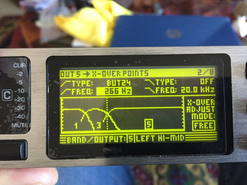

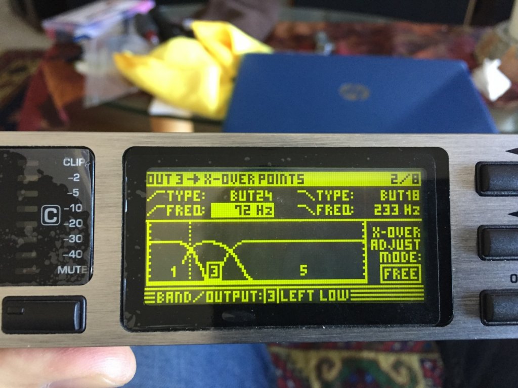

I am setting up my digital crossover for my V60s and I need a clarification on slopes of the crossovers points.
Is the low pass going to the bass 233 Hz with 18dB slope and high pass going to mid/tweet 266 Hz with 24dB slopes or vice a versa (233 Hz with 24dB slope and 266Hz with 18dB slope)?
From the above post, “The 6.5" mid-bass drivers of the V60 are set to take over from 233 Hz on down from the DCX where they roll off naturally.  Brian felt the gap between 233 and 266 Hz allows the best blend between the upper bass and midrange drivers.  They are both Butterworth with one at 18 and the other at 24.”

The bass moduleof the V60 has a high pass filter of 233 Hz (Butterworth 24db)  The wing section has a low pass filter of 266 Hz (Butterworth 6db)
Housteau
Re: Going Digial with the DCX 2496
« Reply #18 on: 15 Aug 2020, 08:18 pm »
In my room the 6db slope works best.
