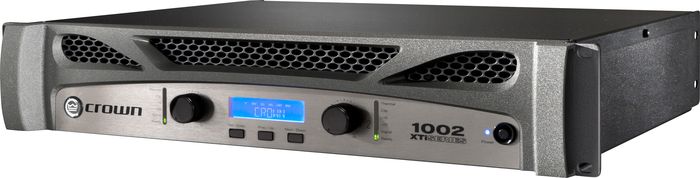

I use a Crown XTi 1002 powering twin 8" bass drivers on my VMPS RM1, 500W @ 4ohms, below 250Hz.
DSP with 50 presets, 49 user definable. With 2 separate 8-band EQ, XO, etc. plus a DSP bypass mode.
http://www.crownaudio.com/xti-2-series.html
Only drawback is the fan, when pushed fan noise is audible during quiet music passages, just barely but audible nonetheless. I will sub in a quiet(er) fan once I pass 1 year ownership.
