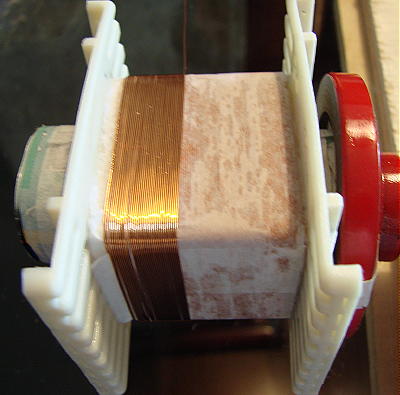

The bad, (maybe manufactured for guitar).
Bad winding: E I core + thick wire and spaced turns
http://diy-rbt3.tripod.com/dcts/index.album/enrolamento-primario?i=1
Final result: crap (200Hz).
Below a proper wind from other manufacturer intend for audio use:
« Last Edit: 1 Mar 2013, 06:45 pm by FULLRANGEMAN »
