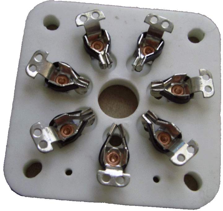

If your sockets are this or use this kind claw contact, you will have bad contact issues sonner or later, maybe after 5K hours.
But it is very cheap, just one dolar in China, and for batch purchase it cost even less.
