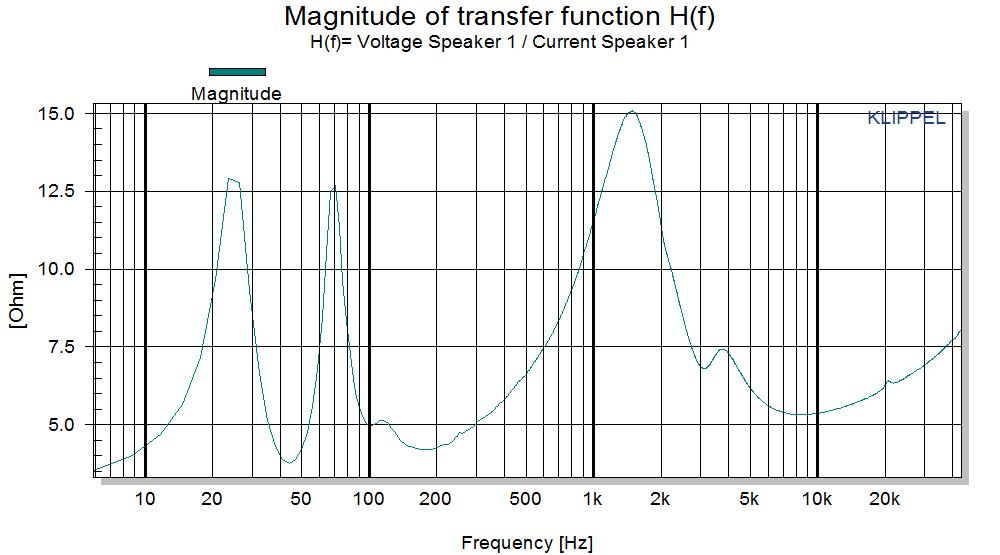

Please find the impedence plot attached.
Monitor Audio has built in crossover network in bi WIRE configuration .So will that protect against tweeter starting oscillation in output circuit?
Is the possibility of oscillation is related to multi strand wire or it is from wire being of low inductance and hence reactance?
What are the symptoms of oscillation ?
My amp is a tube with output transformers are they more prone to this issue than solid state device?
Using an 8ohm tap over 4 ohm or 4ohm over 8ohm provide any benefit in this situation?
Some of my questions are silly  :oops:
Oscillation due to weird cables is a result of what the amplifier sees at high frequencies at it's output terminals.  One condition of amplifier stability when high negative feedback is used is that the output load does not force a large phase shift of the signal being fed back before the amplifier internally runs out of gain at hf.  (if you break the amplifier feedback loop and put signal into the input, at some rather high frequency the amplifier's gain will be 1, that is the unity gain frequency.).  Sufficient phase shift can cause the feedback to go positive, and if it does this before the amplifier runs out of gain, it will oscillate.
In a low inductance cable, capacitance will be high. If the cable has a line impedance of 8 and the load is 8, the amp will only see resistance.  If the load becomes very high above the audio band, then current draw will be lower and the amp still sees the cable capacitance.  So as the load "lets go" at hf, the only thing left is capacitance, which can cause phase shift.
Nowadays, most amps aren't designed fast enough to have this problem.
Bad oscillation at hf will result in smoke either in the amp, tweeter, or crossover.  Low level oscillation would just compromise the sound.
SS vs tube, it really only matters if the design allows excessive phase shift before unity gain frequency.
Sorry for the length of the post.
jn

I was thinking of using Goertz M1 (http://www.goertzaudio.com/contents/en-us/d16_MI_Speaker_Cables.html)   instead of DYI wire since it has the lowest inductance value I know.I just noticed that the Impedence is 4. So I was planning to use Goertz M1 for HF and ZIP cord for LF since the capacitance of Goertz cable is 500pF /feet :roll:. But from this discussion it seems like Zip cord even with low capacitance offers higher impedence.
But going back to wikipedia the capacitance affect LF (copied from wikipedia)
 This table shows the capacitive reactance in ohms (higher means lower loss) for various frequencies and capacitances; highlighted rows represent loss greater than 1% at 30 volts RMS:
The voltage on a speaker wire depends on amplifier power; for a 100-watt-per-channel amplifier, the voltage will be about 30 volts RMS. At such voltage, a 1% loss will occur at 3,000 ohms or less of capacitive reactance. Therefore, to keep audible (up to 20,000 Hz) losses below 1%, the total capacitance in the cabling must be kept below about 2,700 pF.
Ordinary lamp cord has a capacitance of 10–20 pF per foot, plus a few picofarads of stray capacitance, so a 50 foot run (100 total feet of conductor) will have less than 1% capacitive loss in the audible range. Some premium speaker cables have higher capacitance in order to have lower inductance; 100–300 pF is typical, in which case the capacitive loss will exceed 1% for runs longer than about 5 feet (10 feet of conductor).
I am not sure at this point should I be looking at impedence of the wire vs each reactance seperate?
