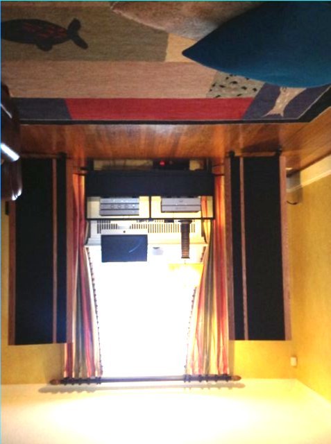

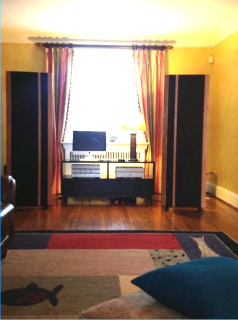

Your sound stage will be a bit larger with the tweeters to the outside. And I don't mean swap them both and put the feet in the same place. That actually moves them in. Mark where the main panels are (that is what determines the image placement and focus), and swap the two speakers putting the main panels in the same spot, but with the tweeters to the outside. That will open up the sound stage a bit.
jaylevine
  • Posts: 344
Re: Maggie 3.7s and 'fast' sub-woofers
« Reply #59 on: 23 Feb 2013, 11:15 pm »
"...swap the speakers putting the main panels in the same spot...."
If I understand you this will move the speakers farther apart relative to their inside measurement when the tweeters where 'in"?
BTW: listening to "Truth" by Amaan and Ayaan Ali khan--stunning and simply beautiful on the 3.7s
