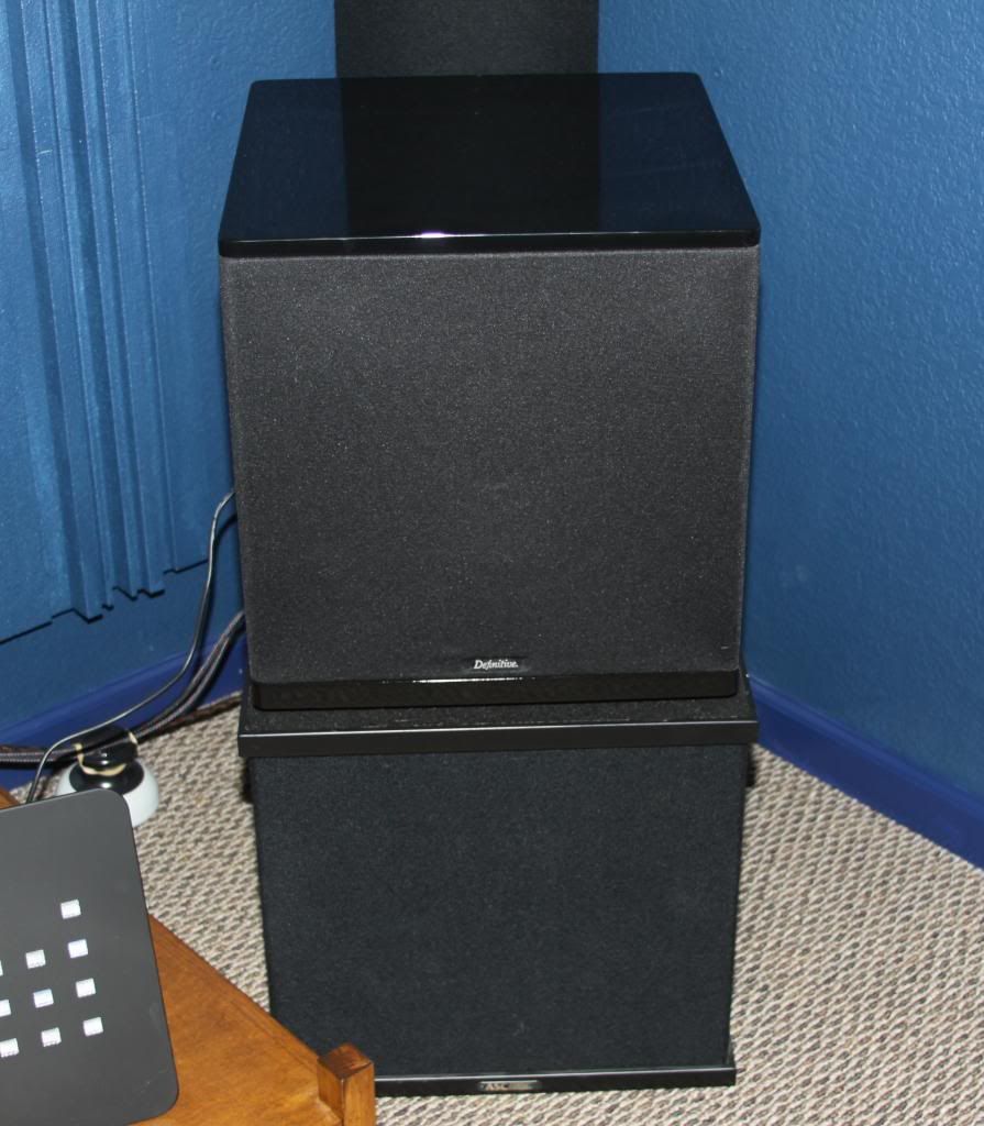

Well, the 3.7s are 9' out from the walls but that doesn't place them 9' in front of the subs - those subs are in front of the walls too. :wink: That spacing is more like 6'. Although that is fairly significant, it's not so great at the frequencies in question and the phase knob helped too. I'm not using any filtering in the sub; that function is handled by an active crossover.
Here's a photo of one of my 3D subs... :lol:
