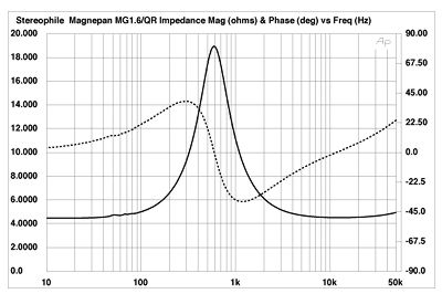

*Scotty*
Re: What is the best amp for Magnepan's
« Reply #57 on: 31 Jan 2013, 03:12 am »
Here are a couple of phase/impedance graphs courtesy of Stereophile.
The first one is the 1.6R
Magnepan MG1.6/QR, electrical impedance (solid) and phase (dashed) (2 ohms/vertical div.).
The second one is the 3.6R
Magnepan MG3.6/R, electrical impedance (solid) and phase (dashed). (2 ohms/vertical div.)
 I guess I'm just not seeing the problem with driving these kinds of loads.
The speakers are relatively insensitive at a Stereophile guesstimated 83dB/1watt/meter. Magnepan sensitivity measurement reflects the 4ohm nature of the speaker in that when fed 2.83 volts twice the current will be drawn from the amplifier which results in an 86dB sensitivity rating.
 That being said I still don't see them as a power hog. 10watts in gives 93dB@1 meter, 100watts is 103dB @ 1meter. In as much as they are line sources they don't fall down with distance the way a point source does.
Scotty
josh358
  • Posts: 1240
« Reply #58 on: 31 Jan 2013, 03:27 am »
Scotty
No, they're easy loads (though I agree with Davey -- the best approach with any speaker is to put the crossover ahead of the amps). The speakers are on the inefficient side, though. You do gain a bit from the 1/R radiation pattern of the full height ones but you also lose room gain because of dipole cancellation. Per your figures, you'll need a 100 watt amp to listen at moderate levels, a big one to listen at realistic ones, e.g., a minimum of 115 dB peaks (which most audiophiles don't, so no bother for most). So that's what some people complain about. Really, it isn't a problem if you're cool with solid state, since big, economical, high quality solid state amps are available. But people who want to use SET amps will find little joy.
Wendell points out BTW that it would cost more to increase efficiency by using neodynium magnets than it does to get a bigger amp if you need high levels.
It's easy to see though how the misapprehension that Maggies don't play loud occurs, if you go to a dealer and turn it up to see what it will do and the dealer has a 100 or 200 watt amp on it well it will peter out. The same audiophile might be happy with a 200 watt amp at home, since he doesn't normally listen at those levels.
