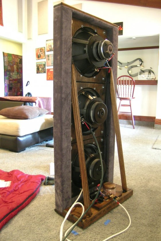

Hello.
I have a pair of Hawthorne Audio Duet open baffle speakers.  15" Silver Iris midwoofer with the upgraded Radian compression drivers.  Custom built passive crossovers to "seam" this combo together.
15" Augie bass drivers as well.
These drivers are mounted to an 1 1/2" thick solid Oak baffle.
The SI / Radian coaxial is driven by my custom built Jim Nicholls tube amp and the Augie's are being driven by a Keiga plate amp.
My "dilemma" is that I'm a bit of a bass head.  I don't really listen to much rap or etc. that has a real demand for crazy bass however, I must admit I love to have that full, deep bass sound if possible.  I do not use tone controls at all.
So I've considered how I might be able to "add" a bit more bass.  I've thought of adding on to my existing baffles and turning them into Trios by adding another Augie.  This will cost a bit due to the custom wood work (I have someone already ready and willing to do it though) and the drivers themselves.
I've considered putting my existing Augie's in "h frames" instead of the flat baffles.  This would be cheaper but not sure how much of a result I would get and I really don't want to cut up my existing baffles if I don't have to, especially if the reward isn't really worth it.
The final thing I've considered is taking the current baffles for the duets and making them "Augie" only baffles with a pair of Augie's in each.  This would be great I think.  However, what to do with my existing coaxials then?  I could of course have new baffles made for them but what design for them since my current baffles for my Duets are approx. 37 1/2" tall with the base and putting a solo 15" SI coaxial at the top of a baffle this tall probably isn't the best design.
So this leaves me asking you fellow open baffle "experts" what you would do?  any ideas, suggestions?  any and all would be greatly appreciated.
