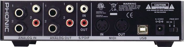

But no one seems to make converters that will do 24/96 or 24/192 or 24/196 to coax or toslink?
You're right.  Those who would convert their analog phono to digital almost always do it to record to a digital file, hence the USB computer connection, but very few would convert it to digital and back to analog just for playback purposes.
There are a few home studio USB Audio Interfaces with 24/96 or 24/192 ADCs that have (a) RCA analog inputs (b) coaxial S/PDIF output and (c) an external DC power supply (so as not to require USB power).
One of them is the Phonic Firefly 302 USB ($150) and there may be others with these features. *
I am told these would work with a stereo analog input and digital S/PDIF output without connection to a computer by a Musicians Friend associate, but I would double check with the manufacturer.
Steve
* The E-Mu 0404 USB that Harold referenced above looks like another one that would work.  It offers both Toslink and Coaxial S/PDIF, but would require 1/4" > RCA adapters or cables for input into the combo Mic/Line inputs as well as physical connection from both the front and rear of the unit.

the usb section of the firefly would require a computer but i could probably use the spdif section instead much like the creative device can. (id need to double check tho.)
however both are 150$+ and i hoped to spend less ;-)

Unfortunately that seems to be the spread between the home studio devices and the cheapo 16/48 device, but there is a new Firefly listed on eBay for Buy It Now $110 shipped, if that helps.
