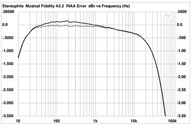

Here's what Stereophile's measurements said about the A3.2 integrated, which most likely has the exact same phonostage:
"Phono frequency response (fig.1), again measured at the preamp outputs, was characterized by a slightly shelved-down treble, with the ultrasonic output rolling off above 20kHz. Given the wide frequency range covered, the treble shelf will be audible as a slight warming of the sound. The MC phono overload margins were good, at 24dB at 20Hz, 18.1dB at 1kHz, and 17.1dB at 20kHz, though slightly less good via the MM setting at 15.5dB, 14.8dB, and 15.1dB, respectively, due to the higher-than-usual gain. The phono stage's A-weighted signal/noise ratios were excellent, at 84.4dB (MM) and 68.7dB (MC), though the unweighted, wideband figures were less good: 68.7dB and 56.4dB, respectively."
