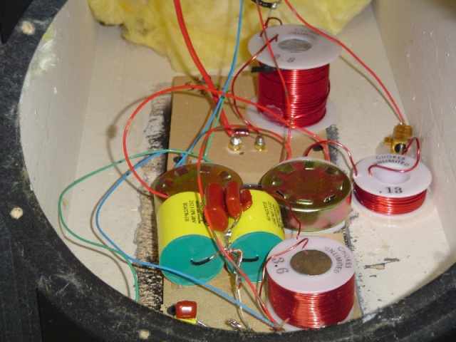

The woofer XO is clearly a simple 1st order coil inductor,Coil in back.  The midrange bandpass XO is a bit odd, Pic, with unusual pairings of inductors and caps.  The tweet XO appears to be a standard 2nd order coil/cap XO, however.
Don't know for sure, but I'm willing to give it a try.  I won't do anything that can't be undone, I hope.
