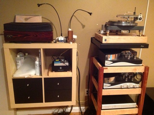

I decided a wall mount would be the only reasonable way to solve this problem and placed a low mass IKEA Expedit 2x2 on the wall, with the 15x20x3 maple block on the cork/rubber pads again. I liked the convenience of it with 4 drawers and room for vinyl accessories, but as I learned later, I wasn't getting the best performance. It eliminated the foot fall problem and significantly reduced the airborne feedback, but tapping on the surfaces still produced bad vibes. I could also induce feedback with the stylus test, though reduced a lot from the rack setup. I replaced the cork/rubber squares with Moongel drum pads, and while they worked well initially, they compressed too much from the mass and became ineffective. I switched back to the Herbie's 1" fat Grungebuster Dots, which helped somewhat. After trying a few other suggested combo's (squash balls, gel pads, etc), I concluded the IKEA shelf was the limiter.

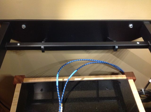

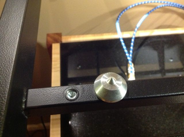

Be prepared for how stout it is. 1x2" heavy steel frame, 1" cross supports, 3/8" thick 6" high steel mounting plate, 28+ lb. worth, and a 3/4" MDF shelf with 1" pockets for the aluminum adjusting points.
The 4 aluminum sockets are threaded into the frame and easily adjusted from below with an allen wrench.
The back plate has a 1/2" vertical mounting slot on the left and a vertical slot on the right allowing alignment on the wall. Once those are bolted in, it's a simple matter to level it in the lateral plane by adjusting those two bolts.

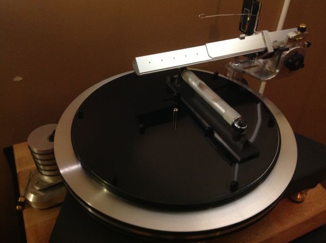

Next, drop the cones in, followed by the MDF shelf, and adjust for level with the allen wrench from below. Mike Galusha suggested the Starrett 8" machinist level awhile back and it makes the leveling steps child's play. This is the second cut at level.
Adding the maple block, followed by a heavy turntable will deflect it ever so slightly to the front edge, so level again, and then again. The Starrett doesn't lie, otherwise you might miss the change. With an air bearing tonearm with almost no friction other than wiring, it is absolutely a must. Same for uni-pivots if you want the best performance.
This turned out to be an optimum combination. I could tap on any of the surfaces (maple block, slate plinth, MDF, steel frame), with virtually no feedback at all, a huge difference from where I started. The feedback test with the stationary stylus was dead quiet - finally, success! The listening test told the same story, deep and totally clean bass, no ill habits whatsoever. This also served to clean up the lower midrange as well. The composite is just an effortless and very dynamic sound, much more so than before.
I was even able to re-use the Expedit for storage and a convenient shelf for the Nitty Gritty and supplies.

Say, how did you mount your Expedit?  Nice job.

Thanks Jeff.
I just used the typical slotted L angle brackets IKEA provides with the 2x2. One went into a stud, the other into a toggle bolt behind the drywall. It is quite solid.
