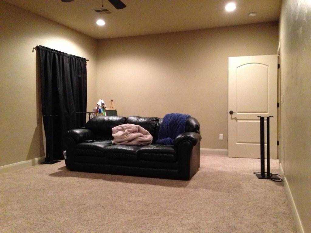

Hello Folks,
I have a HT room that I want to get treated.  I submitted my info for the GIK room analysis but felt like I was pulling teeth in order to get the basic advice I needed.  If I posted my room here is there someone that could help me or perhaps someone I could pay for an evaluation of my layout?
My budget is around $1.5K.  I just need basic room advice on what panels to buy and were to put them.  I'm not expecting a complete 6 hours analysis with CAD drawings and waterfall plots.... just basic room advice. 8)
Thanks in advance!

Bghead8che
  • Posts: 13
Re: Need Room Treatment Advice. Is this the place?
« Reply #8 on: 5 Jan 2013, 04:20 am »
Hi Guys,
If any of you, including Bryan, would be willing to help me that would be great!
I've posted a few images of my room.  The front of room, back, and a full view.  I also posted the dimensions of the room.  The room is located on the 2nd floor of my house with the garage below.
Mainly I am interested in receiving opinions on which GIK products to buy, how many, and where to place them.  The room will be used 50% of the time for watching movies and 50% of the time for listening to music.  I've noticed in the past that bass can sound "thick" and "boomy".  Also, I am very sensitive to brightness and my goal is to take edge off the brightness w/out ending up with a dull sounding room.   Despite reading up on acoustics I simply don't have the expertise to know where to put the treatments, what kind to buy, and how many to use.
Target budget is $1500 but I have no problem with going up or down if needed to obtain the best sound.  I'm putting nearly $40K into equipment so I don't wan to just slap a few panels up.  I really want some advice from people with experience, as you can imagine!
Thanks guys!
(it looks like the HT layout image is hard to read.  Here is a direct link: http:/www.omega-direct.net/2012/images/ht.gif )

Rear corners are out for obvious reasons (door and window).  Don't know what kind of speakers you're using to be able to determine what if any front wall treatment would be appropriate.  If the front is a closet and not used much we can do either Tri Traps or Soffit Traps in the front corners.
242 or 244 panels on the side walls will help tame things a bit though diffusion is another option for the music portion - absorption would be better for HT.
Looks like the seating could/should come forward a bit.
Rear wall I would use 3 Monster panels with our scatter plates to get both some bass control in the back of the room, damp things slightly, and also offer some diffusion in the rear for a more spacious soundfield both for 2 channel and home theater usage.
The ceiling appears to be higher than 8' so additionally some Grid Fusors high on the wall spaced out around the perimeter will help with slap and flutter echo and make the room sound bigger without removing more energy from the room.
Bryan

Bryan,
The speakers are as follows:
Fronts:  Salk Soundscape 8   http://www.salksound.com/soundscape%208%20home.htm
Center: Salk Soundscape C   http://www.salksound.com/soundscape%20center%20-%20home.htm
Rears: Salk Soundscape M7   http://www.salksound.com/soundscape%20m7%20monitor%20-%20home.htm
Considering the room is 50/50 HT and Audio (CDs, streaming music) would you recommend I go with 244s or 242s or a diffusor?  How many panels would you recommend?
I can move the couch easily, if needed.  The front closet is not used much so we can put something in the corner(s).  Do the tri-traps/soffit need to completely flush with the wall?  Can there be space behind them?  The reason I ask is I have mopboards that poke out a couple of inches.
In Summary:
Front of HT
Soffit or Tritrap in each corner.
Which panels should I use on either side of the window and how many?
Rear of HT
3 Monster panels with scatter plates.
Should I put a tri/soffit trap in the corner opposite the door?
Side Walls
242 or 244 panels or diffusion.  Need number of panels and which one to go with?
Ceiling
Are you suggesting the "grid diffusor" model?  They are fairly expensive at $200 for 4 panels.  How many panels would be needed to effectively control slap and echo?
I can hang a panel on either side of the fan in addition to the diffusors.  Would this be a good use of money and which panel(s) would you suggest?
Other
Would a Tritrap behind the couch (on the floor) absorp any bass or would my money be better spent elsewhere?
Thanks for your help!  I'm very excited to get this project going.
-Brian
« Reply #11 on: 6 Jan 2013, 02:46 pm »
I prefer diffusion if you can.  The QRD or Q7D will be appropriate on the reflection zones on the side walls. Probably 2 per side in a mirror imaged pair.  For the budget, probably QRD's.
I would not worry about the rear single corner or behind the couch on the floor.
The Grid Fusors is what I was looking at for high on the walls (not on the ceiling).  At $50 each, they're actually very cost effective.  You can start with 1 box of 4 for now and add more later as budget allows.
Bryan

OK, if I understand correctly here is where we are at:
Front of HT
Rear of HT
Side Walls
4 QRDs or Q7Ds (two on each wall at reflection points)
Ceiling
Grid Diffusors (high on wall)
Bryan,
Please look at the above to see if I made any mistakes.
We are almost there but I have a few questions:
1.  Which panel and quantity would you recommend on the front wall (to the sides of Window behind the TV).  Currently this area is empty.
2.  I'm concerned about using the QRDs on the side walls instead of the 242s or 244s mainly because of my sensitivity to excessive brightness.  Especially considering I am using diffusors on the top walls as well. Would you mind briefly explaining the pros/cons of using diffusion vs absorption on the refelction point?  Off the three you choose diffusion so I am curious.
3.  Since you are suggesting diffusors on the high walls would you suggest panels before and after the ceiling fan?  Maybe hanging 242s?
I REALLY appreicate your time and help thus far!
-Brian
bpape
  • Posts: 4465
    • Sensible Sound Solutions
« Reply #13 on: 22 Jan 2013, 06:11 pm »
Yes - that looks correct.  Sorry for not seeing this sooner.  Just been buried this year.
1.  242 panels would be appropriate on the front wall.
2.  Absorption can certainly be used on the side walls if you prefer.  You can try the 242's from the front wall there and see if you like the result before doing the diffusion in that location.
3.  I wouldn't worry about the ceiling too terribly much in order of priority. The diffusion high on the side walls is to address slap and flutter echo primarily.
Bryan
