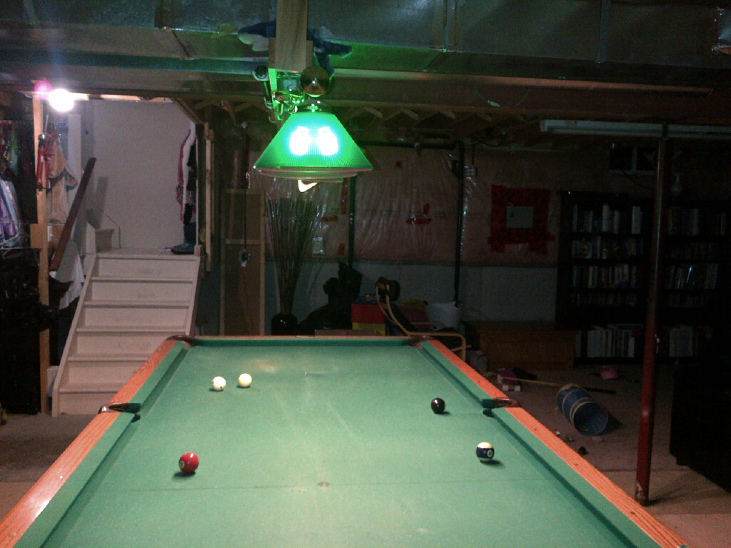

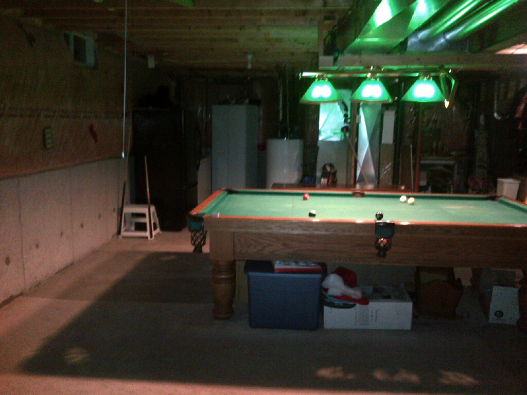

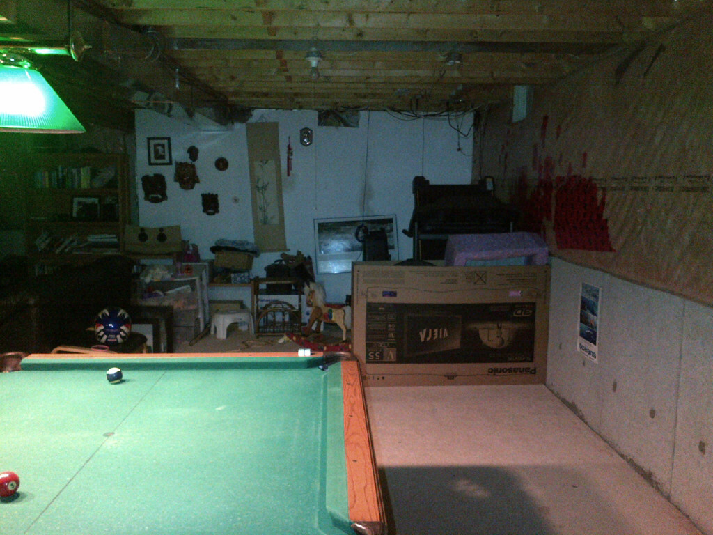

Here is a shot from the pool table, past where the main HT chair would be, and towards where the screen will be - the white wall is where a previous owner of the house shot his PJ.  I am thinking the same wall, as that would allow for pool and HT in the same room once in a while, and more importantly would have the front speakers facing the pool table, so at least I could enjoy tunes while playing pool.
Here is a shot from the proposed screen end, back towards the pool table.  Imagine a chair between you and the pool table, and facing you and that will be the main HT chair.
Lastly, here is a shot of where the PJ would go - roughly in line with the pool light, and over the pool table, firing to the right of this pic, towards the white wall - this is an area that no head would ever hit the PJ.  I am only 5'8, but my best friend is 6'8 and I have many at 6'4 and up, so I am looking to efficiently use my ceiling for them!  If I place the PJ roughly over the main HT chair, folks could hit their head on it potentially.
So, the real question is - while seated in that main HT chair, will my head be in the way?
How about pool players walking around the table?  From what I see online, I would think the stream of light would pass over the HT chair, and potentially the pool players (at least those my height!).
I doubt that it would often happen that the PJ would run and folks would play pool, but it would be nice to figure out if it can work or not.
Currently, there is 92 inches from cement floor to bottom of the joists.  We intend on a subfloor (dricore or similar) and a finished drywall ceiling (likely using Z channel on the bottom of the joists).  There will be a bulkhead running the full length of the basement parallel to the PJ light stream, where you can see the large steel beam and HVAC run in the photo.  That area will be shorter, but I am not yet clear.  I am betting a floor to bulkhead height of just about 6'7 (with associated apologies to my very tall best friend!) as it is around 82 inches in current form.
Thanks!
« Last Edit: 29 Dec 2012, 06:26 pm by mcgsxr »

Ok, great. That helps a lot.
I think you're going to have 'heads' in your screen. Not that anybody will be performing critical viewing during a billiards game, but the pool players will get the full brunt of the lumen output of the PJ, right in their eyes. Especially your really tall friends. The 8350 is a bright SOB. Trust me.  :duh:
One thing you could do is run a string from where the lens would be, down to the lower left corner* of where the screen would be.
Then, you could walk around the room and see where the string hits you in the head.
Not sure I'm making myself clear. I've had a nip of some dry red liquid.  :wink:
Bob
* I'm saying lower left corner, based on the assumption I have the correct "picture" of your planned room layout. THe lower left corner being the most "invaded" corner.

Had a group of friends and their kids over yesterday.
Had a pool game going, and the kids were watching a movie on the other side of the unfinished space.
Based on that experience, and observing how folks circle the table playing, I agree that the PJ cannot go over the pool table.
I will mount it over the main HT chair, about 10-11 feet from the screen.  That will allow total billiard freedom, and will facilitate movie watching (or Superbowl, hockey, March Madness) if necessary.
