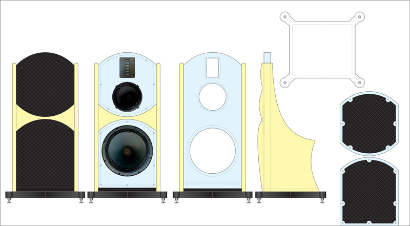

I was in Vietnam, my English is very bad. I love hear speaker Supravox. I just bought 2 pair of the Speaker 215-2000 EXC OB and a pair 400-2000 EXC SC. I'm want to build speakers OB 3 way as drawings include:
- Bass: Supravox 400-2000 EXC SC crossover 100Hz
- Mid: 215-2000 EXC OB, crossover 100Hz-5kHz
- Tweeter: Beyma TPL 150 (Dipole), crossover over 5kHz
So how to use Active xover or passive ?
Thanks for comments !

Even with a pretty big baffle like yours the 8" cant go well as low as 100hz, more realistically 200hz will be doable.
Down there you may need a second woofer or a separated (pair of) subs for the lowest bottom. I know the field coil woofer you bought is very flexible with its adjustable Qt, but it's alone facing a 18db/octave rolloff.

CNC cutting finished pair of speakers
studiotech
Phuong, those baffles are looking nice!  I think you will be fine to use the 215-2000 as low as 100Hz, but you might consider doing subtractive EQ on it rather than additive.  In other words, rather than try to bring up its low frequency response with maybe +10dB of EQ added, try cutting the higher frequencies to get a good balance.  Do you know how loud your average listening level is like?  Also, consider raising the xover point to 150-200Hz, should help if you have problems with it lower.

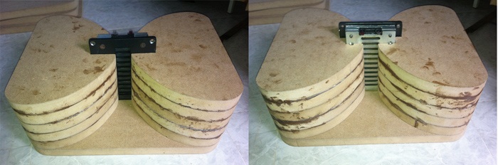

Dipole horn for beyma tpl 150
mgalusha
That looks very interesting, looking forward to your thoughts on how it works.
phuongthu
complete Dipole horn for beyma tpl 150
