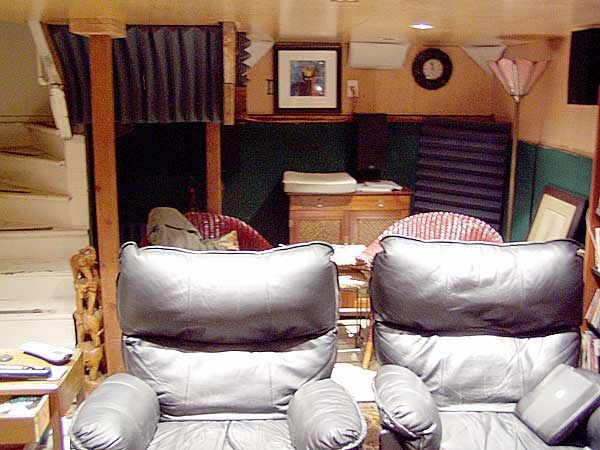

Yeah, I've got 3" acoustic foam wedges sprinkled throughout the room. Right now the back wall looks like:
In the cavity underneath the stairs, I've filled w/ 3" acoustic foam. I'll probably shove some fiberglass bales under there also. I have a 2'x4' foam in the left corner. I've been thinking of replacing the 8th nerve treatments w/ the foam. However, right now echo doesn't seem to be my biggest problem, it's definately the somewhat flakey bass response.
Thanks for the advice, Ethan. I'll try to frame up some hollow panels, cover them w/ fabric and stick some fiberglass rolls inside the openings to the underneath of the house.
