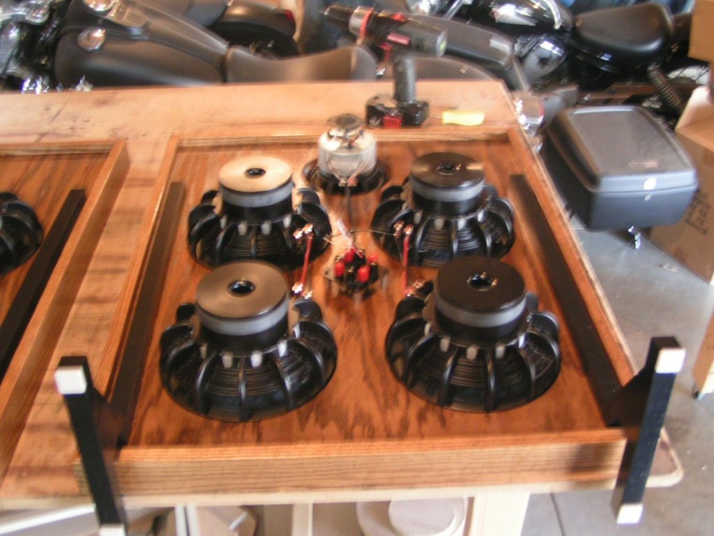

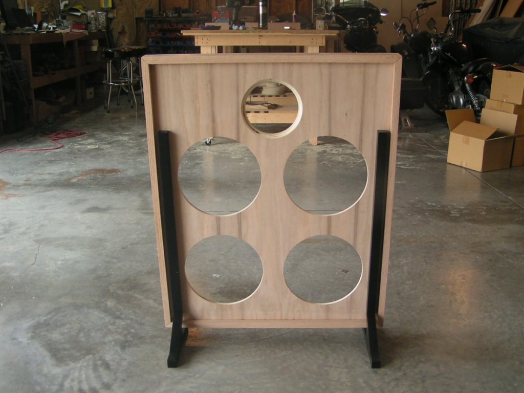

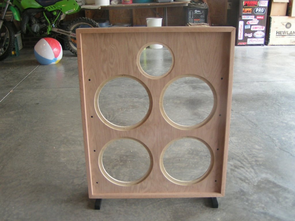

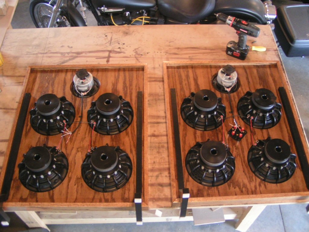

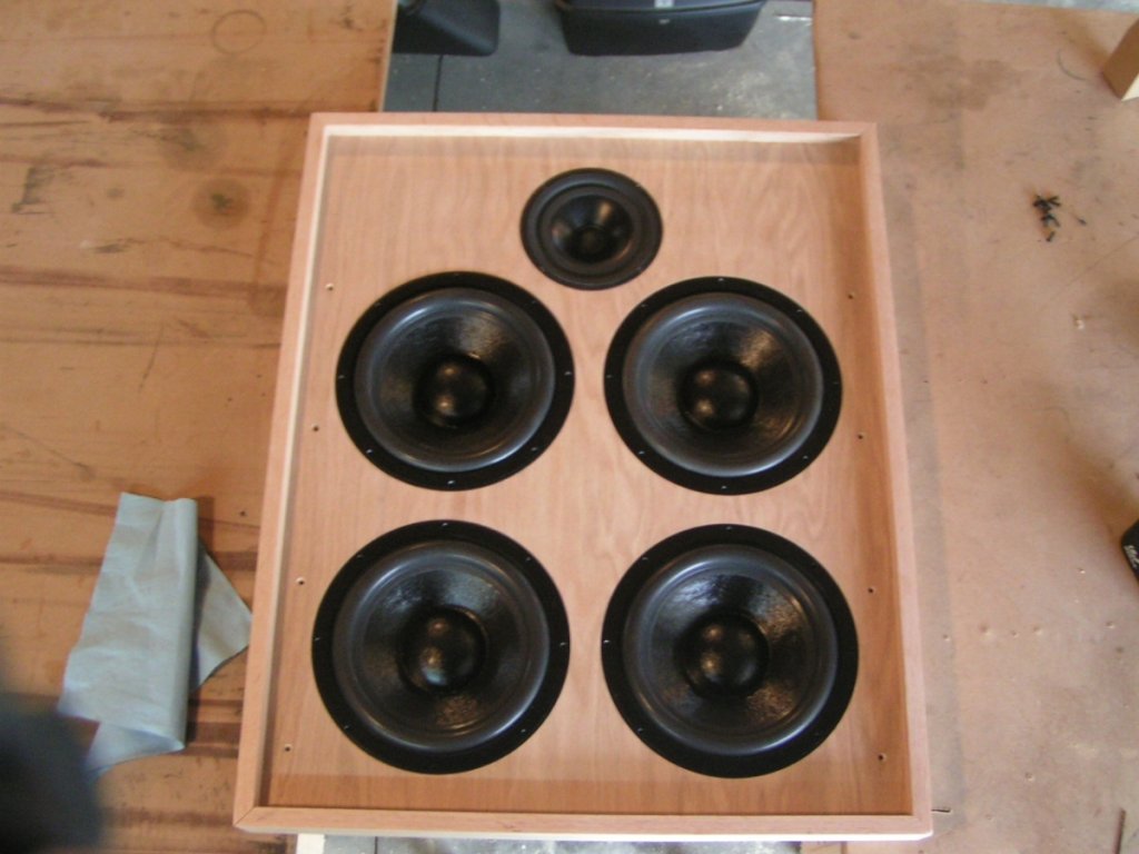

This not my first loudspeaker build but it is my first OB build. I am ready to set them up and play with them a bit. Unfortunately I have no measurement equipment yet. Maybe for Christmas. I used drivers I had laying around. The Mid/High arrangement is Seas H653 Coax (not the best for OB). I axially mounted the matching tweeter (Seas 25TFFN) to the back of the coax magnet with 4mm allthread and a threaded standoff because the tweeter magnet is pre threaded. Not sure if axially mounting the tweeter makes any difference one way or the other but it seemed as good a place to start as any. I have done quite a bit of reading on OB design. There is so much information and opinion that I felt I would be better off just jumping in and working out the issues myself through testing. The Bass section is 4 Exodus DPL-10s that I bought on sale. I didn’t like the big rubber gaskets they came with so I ditched them (may be a mistake as far as vibration) and cut aluminum rings to flush mount them. The Baffle is 27” wide by 32” tall. My plan at this point is the run them 4 way for the first test. Separate amps/channels for front tweet, rear tweet, midrange, and bass. I have the active crossovers and amps on my current system so it is just a matter of plugging them in. running the tweeters separate will allow me to play with the front and rear phase and gain. I will probably find some major issues with this design but I am up for it and I have to start somewhere. I probably should have built test baffles first, but doing it this way also served to try out a new router I bought and also allowed me to polish my wood finishing techniques a bit. I made the baffles out of ¾” red oak plywood (which upon assembly feels a bit thin). This concerns me but we will see. I may be able to minimize the resonance/buffeting by wiring 2 of the woofers out of phase. I dado cut 2” wide ¾” thick solid red oak for the framing.  The legs and all the hardware I water jet cut out of aluminum. At any rate, take a look at the pics. Let me know what you think. I will keep you posted on the tests.
