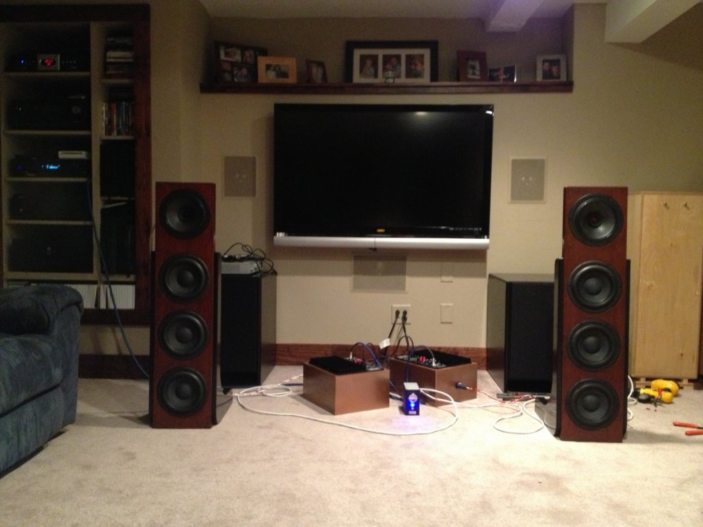

I noticed after some rearranging that one half of my 8 servos were being over driven and sounded muddy.  I switched amps, RCA cords, other stuff and it kept hitting the right speaker. Dug a little further and noticed I had pulled the return series wire from my neutrik connector. Fixed and we are back to control.  Why am I saying this????  The amp was just doing what I told it to do but I failed on the servo control- is this what life is like without a good servo?  Thoughts.  Take one side, by accident, and let it go, chaos began and I could hear it loud and clear.   I am now under tight servo control.  Thank you Brian and Danny.

Ed,  right now the are covering everything below the FS of the Dayton in OB.  Three 8s is almost ~ to 2 twelves when looking at area of cone. I ran some stereophile test tones and turned off the filters, good strong in to very low 20's with my room.  The sure load the room differently than sealed subs.  If u are asking about Super V with H baffle, I would need another 8. Ian actually going to pick up four more 12's and put them in an H to see what the sideby side sounds like.  Also, this baffle is slightly different.    I need more room.
