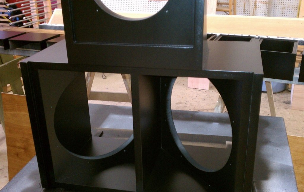

I built these for a guy with Danny's help and direction of being acceptable for sound..   see picture..   It is truly a good match...It is just a V2 Center....  I was mounted just under his screen on a small stand with a 10 degree tilt for the listener.
