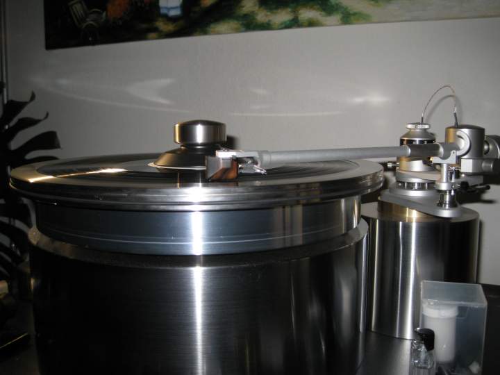

Hey guys, wanted to see if you guys have any advice on how to remove rust from a custom steel plinth.  Anyways, you can see from the picture that this plinth, made from steel, was polished and waxed...then went into storage while I was in between houses and last night, I unpacked it and noticed some minor rust and very fine rust on it.  I tried, removing it last night by using some "Mother's" polish, but that didn't work.  I tried buffing it out with some 00000 steel wool, that didn't work either...
Note, the picture is of the plinth when it looked good....  :thumb:
Any ideas on how to easily remove this stuff?

CLR at Home depot. Do not use any abrasive material.

From the pic it looks like the plinth has a 'brushed' look to it.  I.E. it has concentric 'scratches' all the way around like brushed aluminum.  If this is the case you can use an abrasive on it.  Just make sure you only move the abrasive in the same direction as the original brushing.  Strips of emery cloth might be a good option.  You could also use a coarser steel wool but it would be easier to keep the original brushed look with a long strip of emery cloth wrapped around.  If you'd rather just leave the rust there but make sure it doesn't get worse you could put a very light film of oil over the plinth.  Not my choice but an option.

I'd go with Simichrome jeweler's polish on a cloth and go gently.  You only need to use a little Simichrome, by the way.
Rub in the direction of the brush marks on the metal.
Once the rust is off buff it with WD40 on an old sock or tee shirt; metal is porous so it'll absorb the WD40 and keep it from rusting in the future.
