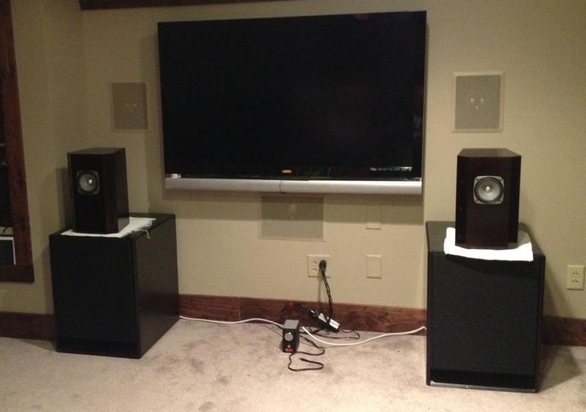

lemiongo
  • Posts: 5
Re: setting speakers on top of subs?
« Reply #1 on: 2 Nov 2012, 06:43 pm »
Like this .....   :)

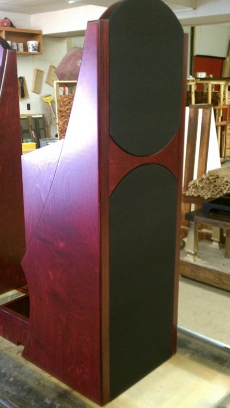

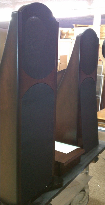

Good question...  what is the difference between this and this...   there is way more power on the bottom of super v's than below the fonkens...and i don't have an answer...I did see a new speaker out that but a sub below, and then had the monitor above it buy was suspended above the sub on special pedestal.... ??
This is what I want to do but using Danny's sealed sub and then install a sealed mtm enclosure with Danny's new midwoofers on its own stand above the sub. Now all I need is for Danny to design the crossover for the sealed mtm :D

Hi Lemiongo, Is that your setup?  If so, do you notice any negative effects from essentially using subs as stands?
jn316:   Yes, that was one of the threads.  It sounds like one of the subs in that thread is more resonant than what Danny builds.  That's why I was wondering if you used his design if it would be better.  I'm sure the sandbox version would be preferred, but what about the question of attaching them and/or combining baffles?
