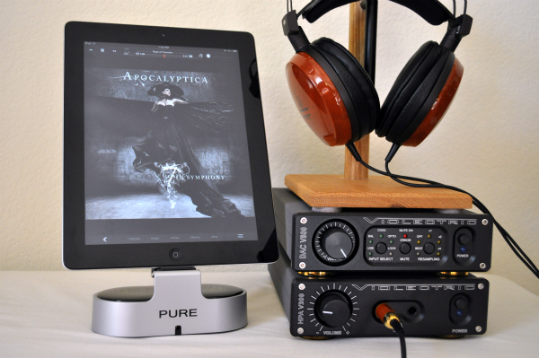

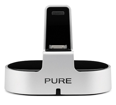

B) Get an IPAD / IPOD / IPHONE dock with SPDIF RCA out.  Often these were grossly overpriced, but there is at least one that retails shipped from Amazon at $100 :
http://www.pure.com/products/product.asp?Product=VL-61429
There may be more similar products out there at even lower cost.
In the end you spend close to the same as the option you presented, and you have a nice ipad holder, remote control, charger (also video out) and most importantly, less hassles & possibly better sound to boot.

Is the Pure i-20 stable enough to hold up an i-pad?
There's nothing to support the iPad other than the connector so it would seem that it would put a lot of strain on the connector.  But some people are using it although comments have been that the small lightweight base is not very stable with the iPad.

I guess the Pure i-20 has a back rest with a rubber pad that is taller than I thought it was, so perhaps the only problem is the light weight and I'm sure DIY types could come up with a marble or granite base to mate with it to solve that.

Hi, this is my first post. I used the Pure i-20  with a cable extender for my ipad. the Pure i-20  did not seem stable enough for the ipad but with a cable extender I did not have to worry about it tipping. I was able to play 24/96 loss less files thru the ipad. How ever I now own a squeezeebox touch so I use my ipad just as a remote now.
