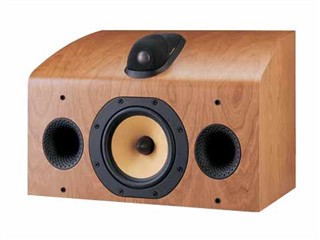

One thing you might also consider is that if you enjoy the sound of the B&W 705, you might consider adding a used HTM 7 center channel speaker.  The 705s are decent sounding speakers and their main fault is only that they don't have a lot of bass output, but what they do have is clean and tight.  With the addition of a well integrated subwoofer(s) the 705s are transformed to provide a very enjoyable full range sound.
The HTM 7 center uses the same drivers as the 705 and is an exact match except for being in a horizontal cabinet.  The only problem might be is that it is a little tall for a just less than 18" wide center channel speaker at 12.1" high, so it depends on your available center channel space dimensions.  Because the 7 series is discontinued, you will need to find a used one, and they pop up now and then on Audiogon and eBay for around $450 - $550.  I owned an HTM 7 and was pleased with it, but sold it when I changed front speakers.

and now...
this just in:
B&W HTM7 in light cherry in 'like new' condition (i can see discoloration on the front from the front grills... anyone know how to remedy that? i prefer running no grills)
audiogon: $350+ shipping.
sold!
hope to have my system up and running next weekend if all the shipping works out!

« Reply #9 on: 20 Oct 2012, 07:56 pm »
Cherry is the most susceptible to darkening with age and exposure to light.  It doesn't have to be direct sunlight either, diffuse room light will do it to a lesser degree.  I have seen numerous B&Ws that have been used with the grill on look like this.
You might be able to even it out a bit, but I doubt you can get rid of the difference entirely without complete refinishing.  There is a satin clear top coat that may or may not respond to penetrating coloration at this point.
I would get some Watco Danish oil in Medium Walnut color.  The Cherry color is a bit too red, and I have found the Medium Walnut to be my "go to" color for most everything.  'Medium Walnut' sounds a bit dark, but here is a picture of it on regular American Red Oak:
You could first try it as is and see if it will take any of the color.  If not, the next step would be to gently remove the clear top finish with fine synthetic 'steel' wool, available at most hardware and home center stores.  You don't want to use actual steel wool, whose particles will find their way to the woofer and tweeter voice coil or dust cap magnetic fields.
You can apply and rub it in with a cloth or even with the synthetic steel wool.  After 10 or 15 minutes, wipe it completely off until the wiping cloths are clean.
At that price, it is a good interim (or long term ?) buy that can be easily sold with little if any loss.  Let us know what you think of the system when you get it all together.  Have you decided on any surrounds yet?
