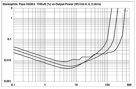

Freo-1, I am not exactly sure that the front channels are all that low powered, according to Stereophiles 2009 review your amp has 195 watts/channel into a 4 ohm load at clipping, defined as 1% THD.
  See link
http://www.stereophile.com/content/pass-labs-xa305-power-amplifier-measurements
If my amp had the Class A power rating yours had I would be in hog heaven, alas it has a much smaller Class A window.
Your system unlike many "low" powered systems should rarely clip on dynamic peaks at anything like reasonable SPL levels. My calculations have you able to reach clean 116db peaks with the front Left and Right channels.
Should be an awesome Home Theater experience, especially on effects laden blockbusters.

Scotty, that's why I said I cheated a bit on the front L/R channels.   :oops:
The larger point I was making was that the center/surround channels add a rich dimension to both music and movies, and the M2 is truly is a low powered amp.  The zero feedback/passive gain provides a clarity and 3D aspect very few S/S amps achieve (and it does this with low power).
I think many folks could achieve great sound with all low wattage amps (provided they also had a subwoofer(s).  In this case, the Signature III's are a 8 driver setup (with 3 10" woofers), hence the need for the XA 30.5 (and no subwoofer).
