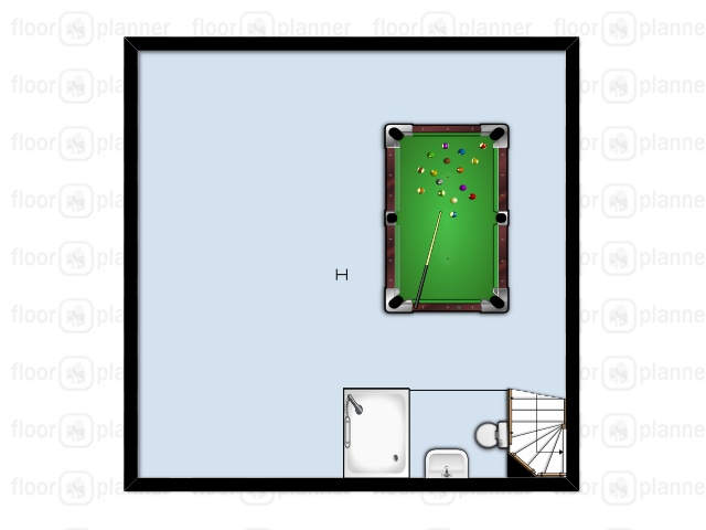

OK, so after 7 years of living in this house, we are now planning to finish the basement.   Still very much in the planning phases, work likely to begin in the January timeframe.  I expect to do some of the work myself.
What it will not be - a dedicated audio or HT.  It won't be soundproofed.
What it will be - pool room, with lounge area and a display of some kind.
We are looking to build it out to accomodate my 4.5x9 pool table, put in a 3 piece bath, and create a basement family room with some kind of video display.
The entire footprint of the finished space will be around 25x25 with 7.5 foot ceilings.   Inside that 25x25, I figure the bathroom will be around 5x10.  Open concept otherwise.
One half of the basement will essentially be a pool playing space, and the other half for family room type activities.
Flooring TBD, but my wife wants to put in a Dricore subfloor to ensure that it is warm down there.
I am considering a PJ, but am not sold.  Budget for display likely in the $1500 range, all in (meaning screen and PJ if going that way, or just Plasma or LED otherwise).
Not sure of size for screen yet, but will have about a 12-13 foot throw available for the PJ.
It will be a compromised space for sure, but an interesting opportunity for a PJ, and the only hope in my house!
Ideas guys?

Below is a bad not to scale drawing, but will highlight the overall idea.

I should have specified that the finished area is the 25x25.  There will be an additional unfinished space behind the right hand wall of 13x25 or so.  That is where the furnace, hot water heater, freezer, 2nd fridge, workbench and storage will live.
I already have the pool table, so that has to stay!
We have a few ducts down there feeding the room with forced air, so I would seek to avoid adding a heating device, but I am sure my wife (and 2 daughters) will have input on that in time.
The advice about panel vs PJ is good.  There will be 3 small windows in that room, no larger than 1x2 feet.  The rest of the house has california shutters, so those 3 windows may end up with those on them too, for light control.

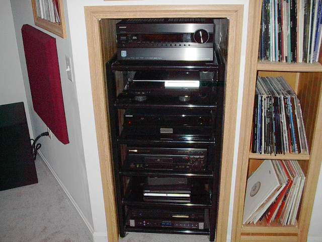

Here's a closer shot of the basement rack recessed into the unfinished area and the spot I originally made for cues that now houses LDs.

Nice use of the built in area there Phil, I like that.  I will do something similar for a bar area to the right of the pool table.
To clarify, I am envisioning the lounge area to the left of the pool table.  The PJ would be hunt off the main trunk that bisects the basement, and fire towards the top wall.  So, the screen or Plasma would be at the top left of the pic - ie beside the pool table to the left, but up top.  Blach, hard to describe!
Let's imagine that the bottom of the pic is south.
That H shaped thing beside the pool table is a post.  Beside the post will be the couch, running east west between the post and the west wall.  Above the couch, on the ceiling, would go the PJ.
Screen will be on the north wall, near the west wall.
